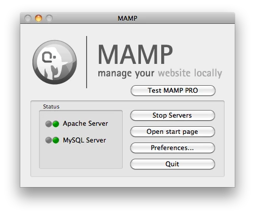

I know that Apache Server and MySQL server are running because of this:

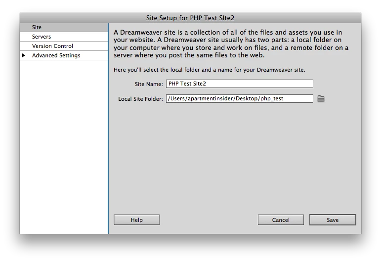

I think the problem is with the site definition here
OR Here
How can I trouble shoot to find out what the problem is?

As the tutorial tells you,the files should be in the document root of the testing server. On MAMP, the document root is located at /Applications/MAMP/htdocs.
The reason it's not working is because you have located the files on your Desktop.
Local site folder and Server folder should be /Applications/MAMP/htdocs/php_test.
