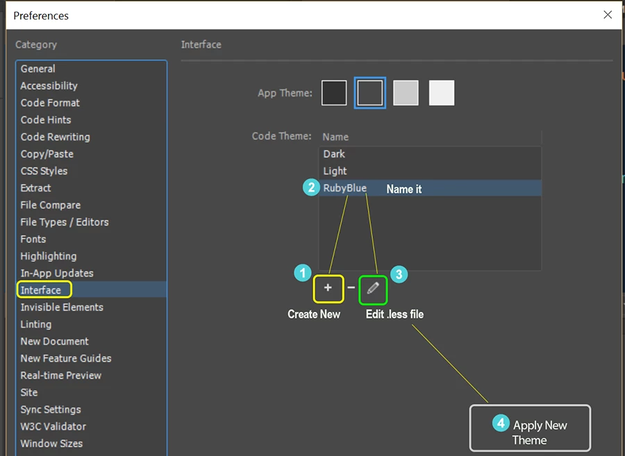

Solution: White on Mint Green Code Color.
This question gets asked a lot lately so I thought I would put together a solution for anyone who is interested.  Incidentally, it works the same for light or dark based code color themes.
Go to Edit > Preferences > Interface
Create a new theme.  See screenshot below.
Name your new Theme.
Edit your new Theme.
At the bottom of your main.LESS file, add the following.
/* Custom code colors or overrides should start after this line */
.CodeMirror-matchingtag {
    color: white !important;
    background-color: navy !important;
Adjust color values to suit.
Save main.LESS file.
Close main.LESS file.
Go back to Preferences and Apply your newly created code Theme.

Which version of DW and OS do you have?
Editing LESS files is no different than editing any other text file.  When done, save your LESS file and close it.  Then Apply your theme in Preferences.
