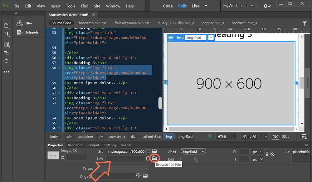

If your site is defined properly, Dreamweaver correctly manages link paths and assets for you from the Properties Panel (Ctrl+F3).  See screenshot.
A schematic map is not something I would use.  Dreameaver has a built-in link checker.  Site > Site Options > Check Links Sitewide (Ctrl+F8).

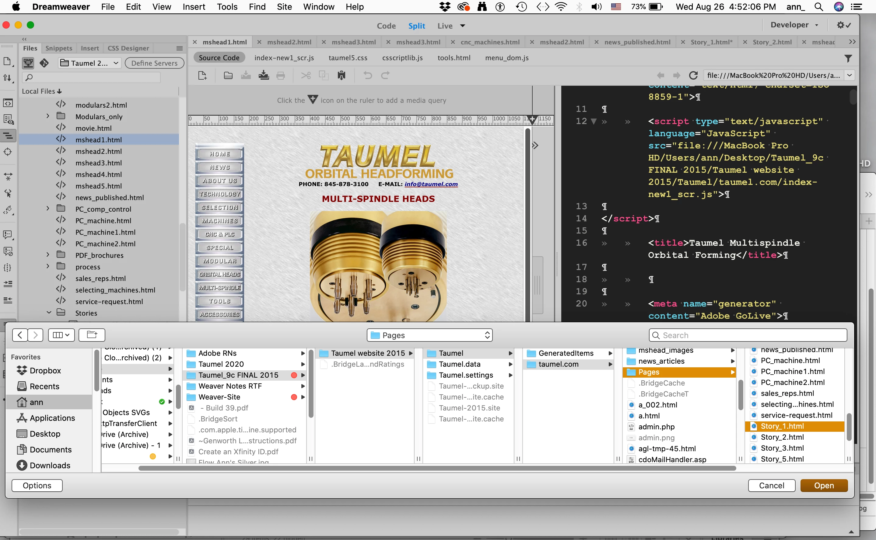

Aug 26, 2020 8:59 PM UTC
Nancy:
We are at cross-purposes! Your screen shot shows DW's image linking for an already existing DW Site. That is a task in which I am entirely competent!
I was doing some thing entirely different i.e.: Collecting up existing HTML Page files and all of their Assets and moving copies of everything into an entirely new DW Site in which I intend to repurpose much of the existing content and incorporate it into an entirely new HTML-coded CSS-based web site using my own template design.
Because of my decidedly cussed nature, I never seem to do anything the easy way so I never use WordPress, Bootstrap or any other downloadable Templates!
For my current purposes, I just need to be able to Navigate from inside my new DW Site across my network to reach each old Page file that I want to import; Open that file from inside DW (complete with all of its previously Linked images); and then Save All and Save As into my new DW Site.
The taskwas perfectly straight-forward (once I discovered the way to do it!) but it would have been nice if my eyes had not been driven to streaming and near-blindness by the totally dreadful UI Designer's decision to grey-out the names of the Folders in my navigational Path.
This is a Screen Shot of my navigational path. All the Folder-names are greyed-out in the UI until after you have clicked on it (where-upon the type does turn black) but reading the greyed type is very tiring on the eyes and I cannot understand what inspired the UI Designer to grey-out Folder-names.
