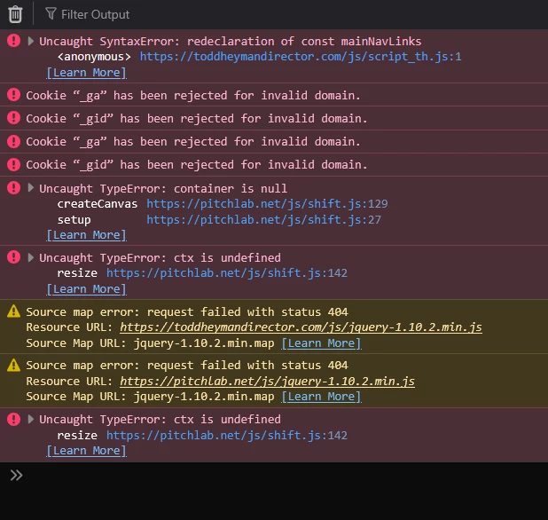

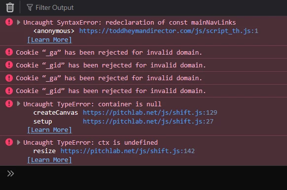

    Nancy OShea
    Mar 4, 2025 9:19 PM UTC
    Browser Inspect (F12), Console:
    Working page:
    Non-working page:
    REELHEROAuthor
    Mar 5, 2025 1:17 AM UTC
    thanks Nancy - I removed those conflicting JS no more 404s but still no go
    https://pitchlab.net/checked_test.html
