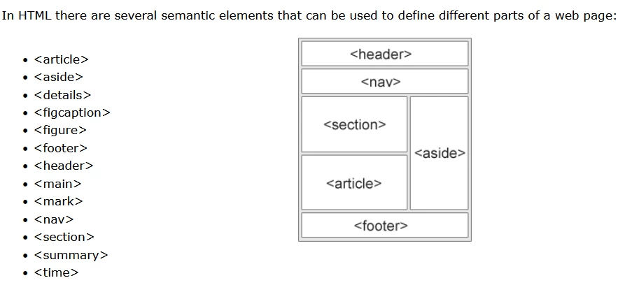

    Tables are never used, except for tabular data (spreadsheets).  Today's layouts are built with semantic HTML tags, styled with CSS. See screenshot.
