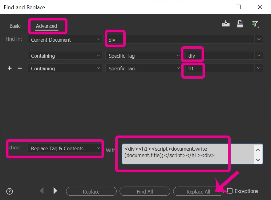

    OK try this:
    Ctrl + Shift + F to bring up Find & Replace.  Advanced Tag.  NOTE: I highly recommend doing this in a test document to ensure it works as desired BEFORE applying to your entire site.  Assuming each Page Title is unique, I'm using JavaScript to grab contents from your document's <title> tag.  See screenshot.
    Hope that helps.
