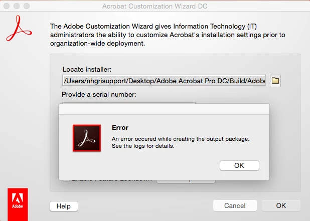

Whenever I attempt to open the installer file I receive the following error:
"An error occurred while creating the output package. See the logs for details."

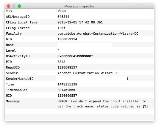

When I look at the console it shows the following:
12/5/15 5:50:08.293 PM Acrobat Customization Wizard DC[4033]: ERROR: Couldn't expand the input installer to get the track name. status code retured is [1]
I have attempted to install the Wizard in various locations including /Applications/ and other folders that have read/write permissions. I have attempted with multiple combinations on the initial Wizard screen.
Please see the attached screenshots.
