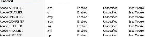

There is only 1 website on the server, this one, so I've set the handler mappings per the documentation as follows:
All are set to the executable path of C:\Windows\Microsoft.NET\Framework\v2.0.50727\aspnet_isapi.dll

    Hi sfksgEE​,
    While you appear to have set IIS up on your server in accordance with our document, there's one thinig I would want you to ensure. Can you please check if MIME type is defined for extensionless file on the IIS manager? This is described in steps 13 and 14 in the below help doc (Under the section titled "Set Up IIS\Apache Server for Use with AUSST" and under the subs section "Set up IIS 8.5")
    Use the Adobe Update Server Setup Tool (AUSST)
    This would modify the web.config located in C:\Windows\Microsoft.NET\Framework\v4.0.30319\Config
    Once done, please try reinstalling any application and see if you are now able to do so.

    sfksgEEAuthor
    Jun 14, 2019 3:44 PM UTC
    I believe I have the mime types configured per the documentation, see the statement I made in the original post:
    The \ACC\services\ffc\validation folder contains the MIME Types per the documentation:
    Any other ideas are appreciated!
