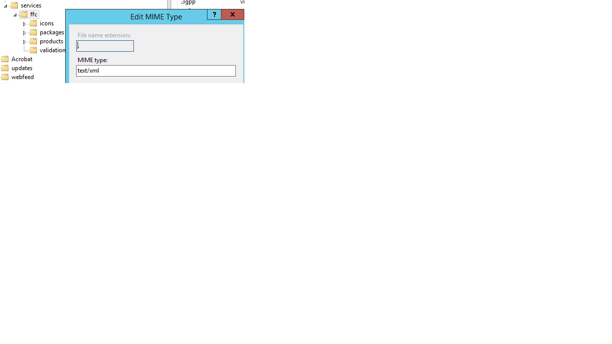

hello,
I come to you because I did not manage to have a solution with the support
We have implemented AUSST,
our tests are done without antivirus, firewall or proxy
we have an error 113 after 7% download,
we don't see an error in the installation,
can you help me
thank you in advance

Hello, Thank you for your prompt response.
Unfortunately my problem with error code 113 still persists after 8% of the download.
Re Hello, my problem is solved, I had to do the reverse of you. That is to say that I had to remove the mime type "."
6 replies
Dec 24, 2020 10:06 AM UTC
I apologize for coming back to the subject. However I have the same problem as you and I think this is from the MIME types too, can you tell me what you changed to make this work?
Thank you
Dec 24, 2020 1:06 PM UTC
you need to add the MIME type "."
Dec 28, 2020 10:43 AM UTC
JB85Author
Feb 17, 2020 8:26 AM UTC
It's Ok
I had a problem with a MIME type the problem is solved
