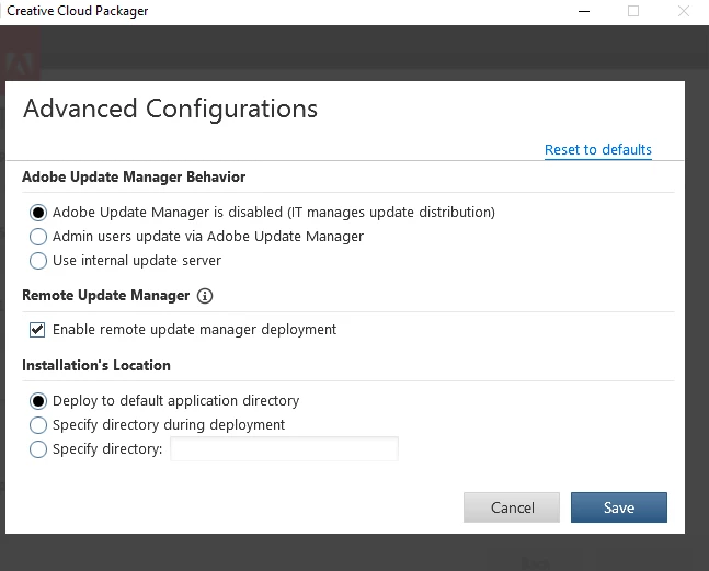

    alisterblack
    alisterblackCorrect answer
    January 24, 2017
    The CCP options should look like this.

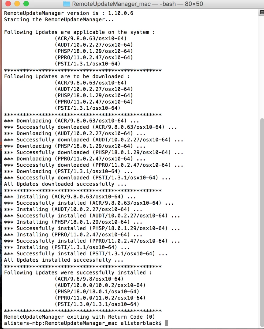

    alisterblack
    January 31, 2017
    I tested this by signing out of the Creative Cloud Desktop App and then running Remote Update Manager. It did not require me to sign in and installed correctly.

    alisterblack
    January 24, 2017

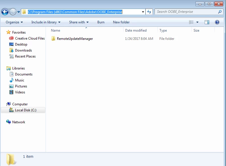

    alisterblack
    January 24, 2017
    What operating system are you installing on to?
    I tried this with a Windows 7 VM and RUM was in this location.

    January 24, 2017
    I followed the link "Use Adobe Remote Update Manager "
    i prepared the package and installed manually on one of my test machine and i don't see the OOBE_Enterprise folder.
    C:\Program Files (x86)\Common Files\Adobe\OOBE_Enterprise\RemoteUpdateManager
    Please guide if i am missing anything.
