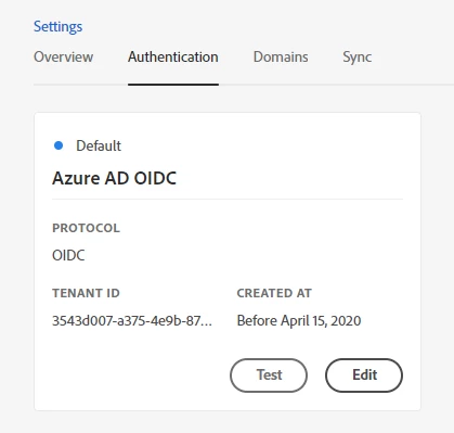

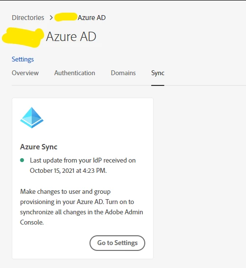

After following the steps of the setup guide from Adobe, it still showing the authentication protocol is OIDC instead of SCIM, is it normal?

Dear @alvin0808 ,
If you have added or plan to add Azure Sync to your set up, it uses SCIM-protocol and offers you control over user and group being sent to Adobe without looking into the Azure directory data.
However, changing to the latest version of Azure Sync with SCIM does not alter the identity authentication setup. Customers could either use OIDC or SAML method for a federated directory and add sync to that directory.
So, all in all, OIDC as the authentication protocol is Normal. 🙂
