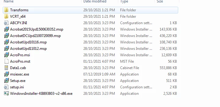

Extracted the zip file.
I went to edit the first adobe MSI package when drilling down into the extracted zip folder (Acrobat DC v1) and wizard returned error.   ( this is where the setup.exe file is also located )
I then drilled down deeper into the folder structure where I found the acropro.msi and mst file.  I tried to open that and wizard opened it up.
I made some changes and it saved.  I then ran setup again but I can't verify if any of the changes actually took.
