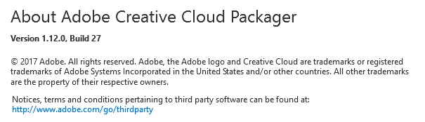

    Creative Cloud Packager will update automatically to the latest version (unless you have unchecked that option)

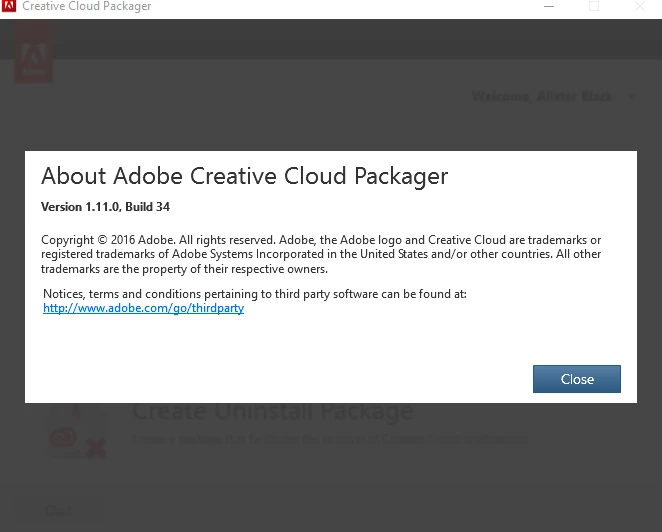

    December 6, 2016
    Hi All,
    There is an update for Creative Cloud Packager released today.
    It contains a fix for the issue discussed in this thread.
    Please install the update, build a new package and try to deploy that. Let us know any feedback.
