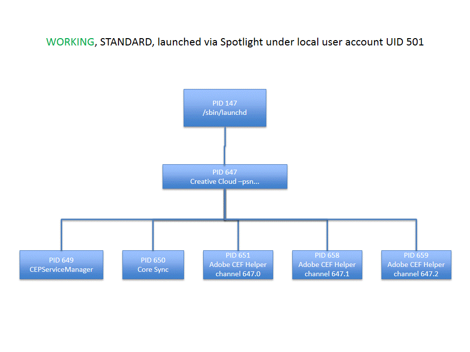

thank you for this proposal, but I already tried this way. The problem is that new users will authenticate with their credentials on the OS X machines, so when they launch Creative Cloud it will not find any Adobe credentials. As i could not find any local file where the Adobe credentials are stored so I could at least distribute this file the only solution is to sudo Creative Cloud as another user (sub-optimal, currently not working), hand over the credentials to the students (bad) or allow login via users on the local machine only and not via network users (bad).
I have attached an overview over the processes when Creative Cloud is launched via spotlight / applications folder and when it is launched via script.
Regards
T-Low
Edit: Running CC with three different users is not intended - it is meant to be just one.
