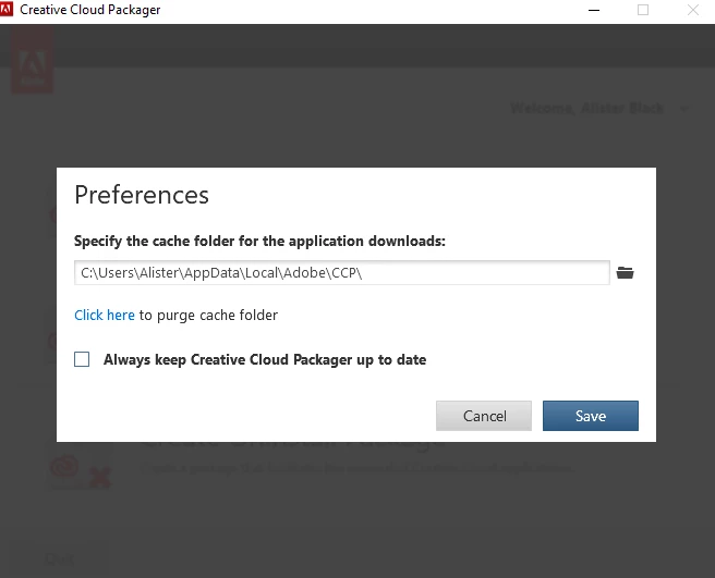

    Is there a way to run CC Packager without it updating?
    alisterblack
    Mar 27, 2019 10:02 AM UTC
    Is there a way to run CC Packager without it updating? There is a preference that will stop updating, but it is still likely to update the first time you run a fresh install. What are you trying to achieve by stopping the update?
