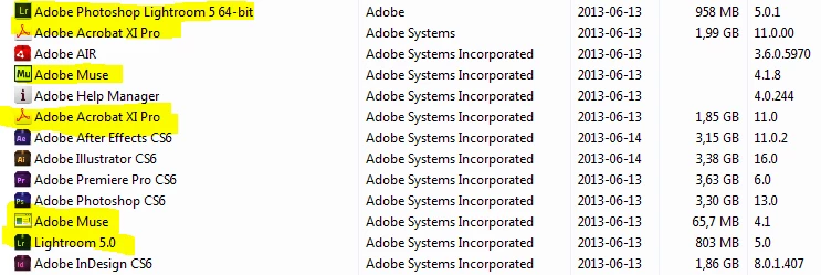

And also, in Add/remove programs i get 2 programs for acrobat, muse and lightroom, is this intended? i get 1 program there when i install the main .msi, and then one more when installing the exception. see attached image.

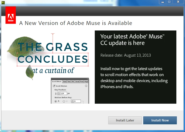

    and what is this? why is there still an popup telling me to update muse when i have checked in the configuration that it shall not look for updates?!

    we still have to choose language when we first start it even if i choosed during the packaging. And now when i start Muse i get a big nasty window in my face screaming at me that there is a new version of Muse. WHY? i have turned of the automatic updates in CCP. and also i cant login.
