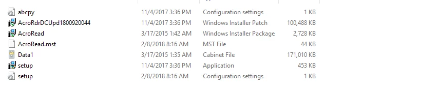

I have downloaded the Zip files with the ADm template and the Customization Wizard etc..
I have extracted and now have a 2018.009.2044 folder I created with the files I need including an mst
I have created my application in SCCM and it is deploying - I am pointing to the
"msiexec /i "AcroRead.msi" /qn TRANSFORMS=AcroRead.mst"
This is working fine but the end result is version 2015.007.20033 installed - I am wondering if I need to also get the AcrordrDCUpd1800920044.msp installed and if so should I be pointing at that initially or do I have to do this separately?
Help appreciated
