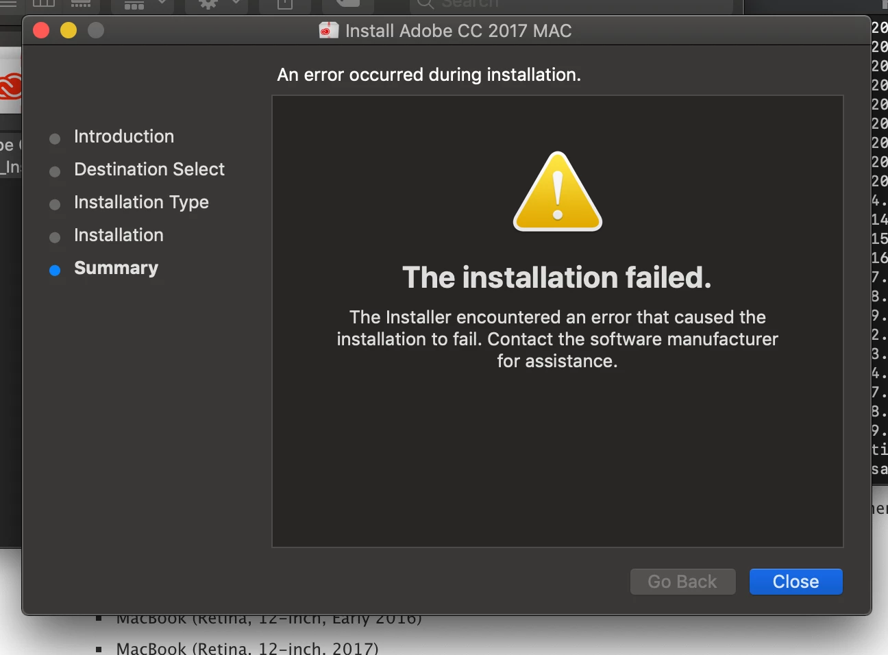

Hi ,
I have created a Adobe package using creative cloud packager on 2017.
By default i have selected all software.
I then proceeded to create a fresh OSX Siera image and begin to manually install the software.
Unfortunatley it pops up with an error message as per attached
Last week i have previously pushed the same software out through deploy studio admin.
Has anyone recently ran into these issues previously?

    We were running in the same issue the last few days. I got my installer package to work again by setting the clock back to 10-1-2016 temporarily (probably don't need to set it back that far but that's what I used) while running the installer and it worked.
    Then, set the clock back to the proper time, sign into CC, run updates, and everything seems to work fine. This is going to be our workaround until Adobe finds a fix.

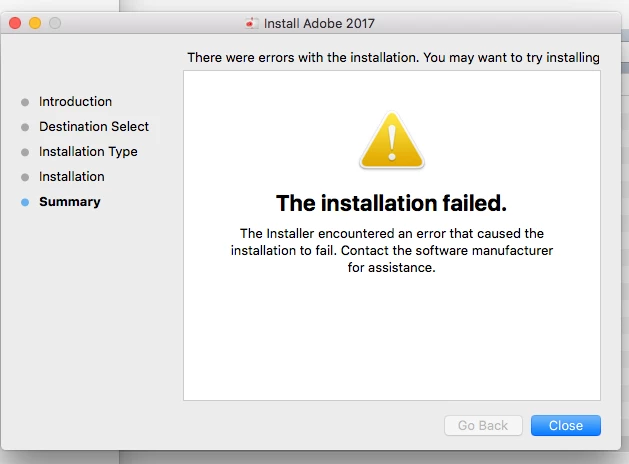

    Hello people,
    I still have this problem. Am currently using MAC OS Mojave and my college provided me with adobe cc 2017 package to use, but i cant install. Please let me know how i should proceed.
    Thanks

    Mar 1, 2017 10:24 AM UTC
    Please refer to this document.
    We are aware of this issue and are working on an urgent fix.
