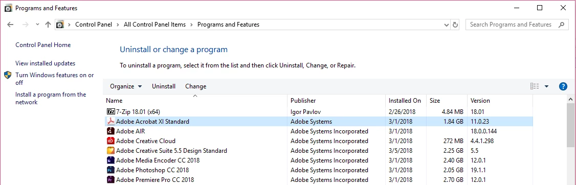

Thank you for your two previous replies.  I've provided some screenshots to help me answer your question.  On this machine, Acrobat XI Standard, Photoshop CC, Premiere Pro CC, Media Encoder CC, and the Creative Cloud app are installed.  I also have InDesign CS 5.5 installed which is why you see Adobe Creative Suite 5.5 Design Standard in the list.

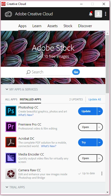

When I open the Creative Cloud app, it says I have two updates pending:

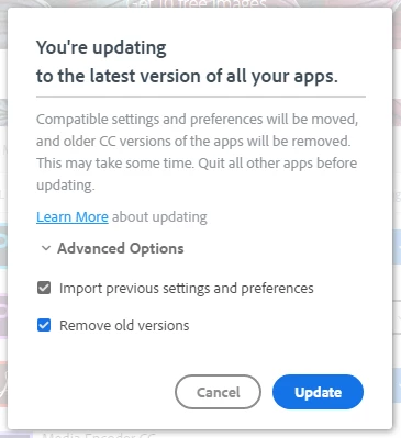

One for Photoshop and one for Acrobat DC (which is not installed).  The button beside Acrobat DC says "Try" now.  If you reference my screenshots from previous posts you can see it use to say "Update".  This must have been changed since my original post.  When I select "Update All" I get this window:
If I un-check "Remove old versions" the text changes to read, "Older CC versions of the app will not be removed."

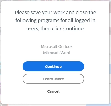

With the box unchecked, I select "Update" and I get one last window asking me to close Outlook and Word.  This is a indicator to me that Acrobat is about to be installed since Acrobat's PDFmaker plugin requires Office apps be closed before installing.
Surprisingly once the update finished, Acrobat XI was still installed alongside an install of Acrobat DC:
This was definitely not the case previously.  In the past, un-checking "Remove old versions" would still result in Acrobat XI being uninstalled.  I'm glad to see this new result after updating all the apps.  I'd like to double check the behaviour when the "Remove old versions" check box remains checked but I don't have time today.  I'll reply back tomorrow once I've tested that.
Here's more info. Again, CC app issues are likely better posted on a CC forum, but here's how the CC app should work WRT Acrobat:
  • There is no scenario where the app can silently remove a licensed product (unless there's a bug).
  • If a licensed product exists on the machine and the workflow is going to initiate an uninstall, the user is asked first for permission (the user must un-check a checkbox to allow removing the previous version)
  • If the user has a licensed 11.x product and no entitlement for Acrobat DC (serial or named user license), then Acrobat DC can be installed in trial mode and both products can coexist on a machine.
  • If the user has a subscription to an earlier version or has installed a trial, then it makes sense that the user can upgrade to DC and uninstall the existing product. Again, the user is asked for permission to allow that uninstall.
It comes down to admin control: Either prevent the user from updating altogether, allow them to update, or educate them about how to upgrade in the requisite context.
