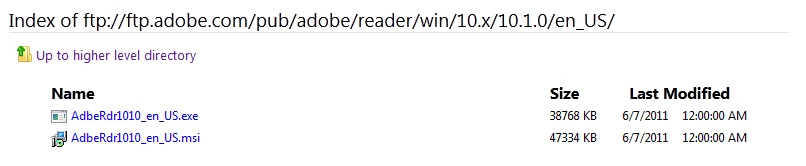

There is also an Adobe FTP site.  If you navigate down into the Reader 10.1.0 folder there is an MSI file.  Good - but it's the old version.

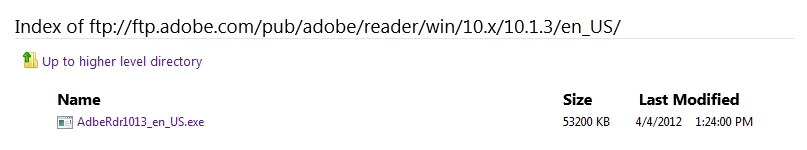

You would think that if you navigate into the 10.1.3 folder there would be an MSI there as well.

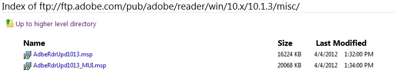

Unfortunately there is not.  However, there is an MSP file found in the misc folder:
I have tried several methods that are supposed to combine the MSP file with the MSI file - they have not worked.
