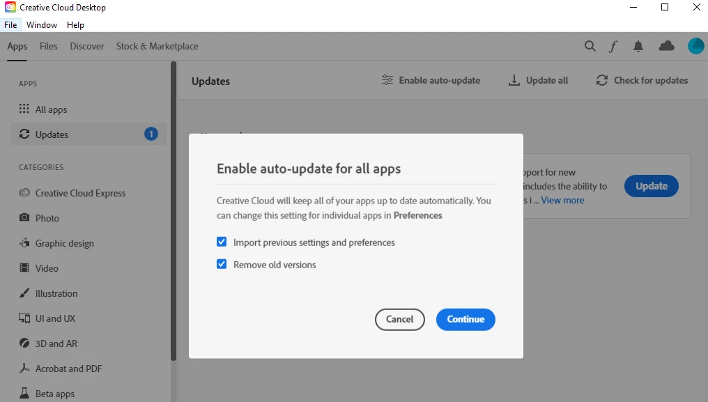

Enable Auto-update for all Apps on Adobe Creative cloud on enterprise

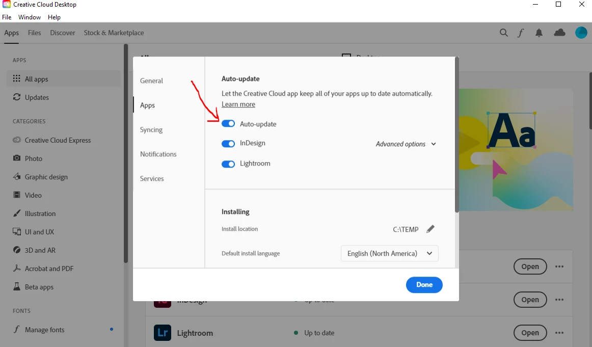

Anyone knows hot to enable the Auto update for all apps on the adobe CC for all computers on the network? i have already configured the package, configured the ServiceConfig.xml to have Selfservice and appsautoupdate both enable. still, these 2 settings ( attached ) are still off. i noticed if i only trigged this manually the feature will work and the apps will update automatically.
How to delpy this to the domain conputers that has Adobe CC?
thanks on advanced

Hi MATT5C4A
This is expected behavior; the end users must switch on the Auto-update from CCDA.
This is also available on our public KB - https://helpx.adobe.com/enterprise/using/manage-self-service-policies.html#for-admins
Please look under - AUTOMATICALLY UPDATE ALL APPLICATIONS.
