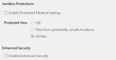

This configuration leaves the Reader with the following configuration

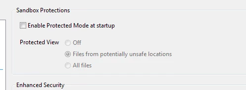

Start adobe reader – settings – security (enhanced)  uncheck “Enable Protected Mode at startup”
No problem so far, then force a GPupdate /force – this then activates the settings
Protected View:  “Files from potentially unsafe locations”   and keeps the “Enable Protected mode at startup “ un checked = this setting is a Unsupported configuration (https://www.adobe.com/devnet-docs/acrobatetk/tools/AppSec/protectedmode.html)

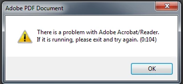

That situation will cause the error below. As soon a pdf file is launched from a potential unsafe location. (= any pdf file from the Internet)
I believe we should ensure that we cannot fall into a unsupported configuration =
When  “Enable Protected Mode at startup” is unchecked – then Protected View:  must be set on Off
This issue will only be experienced when a User is unchecking “Enable Protected Mode at startup” but once this is done and the next GPO Update appears these Users will have an error.
