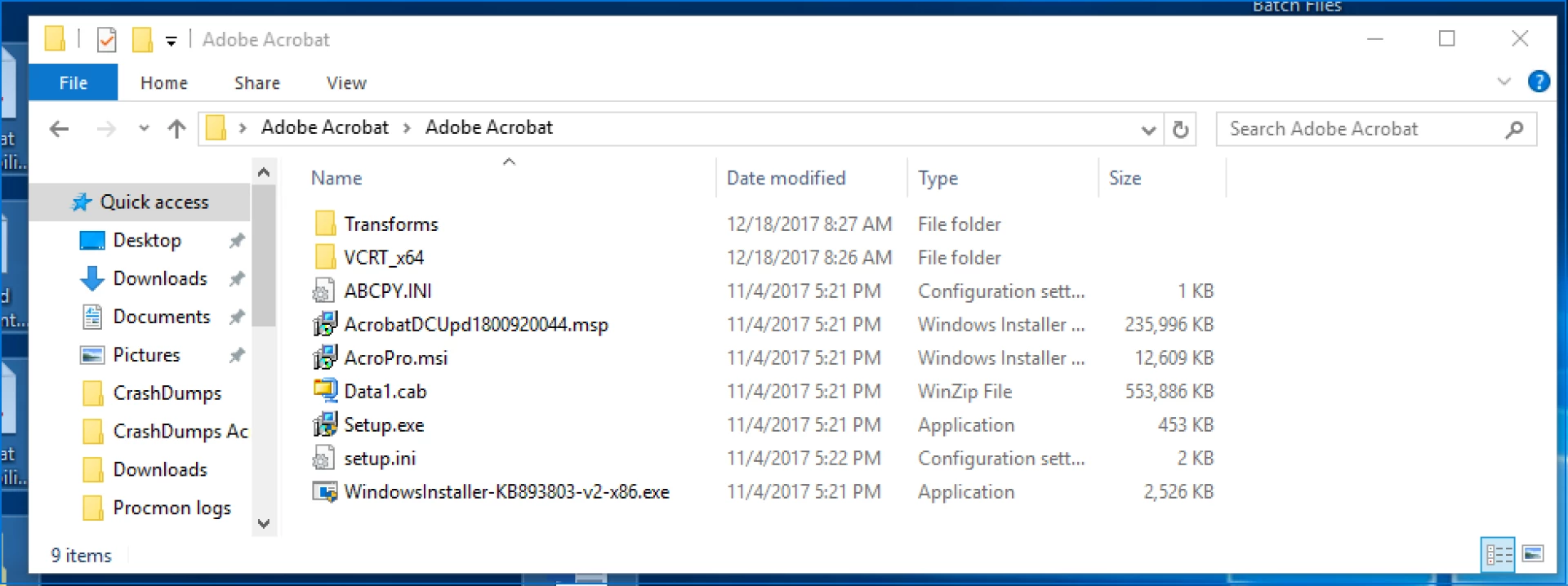

I have a suggestion that you are free to use or not use.  This is definitely a workaround suggestion but try going into the Acrobat folder and finding the files that look similar to this:
Use the command line for Setup.exe syntax:
Setup.exe /sl "[LangCode]" /sALL
Sep 7, 2018 8:58 AM UTC
Hi
With this setup, installation work fine. But i have only Creative Cloud Ent Serial Key.
i can't use this Setup for deploy Acrobat Pro 18.
When i use the command line with elevated privileges " Setup.exe /sl "[LangCode]" /sALL"  with CCP's Setup i have this message   " setup must be launched with elevated privileges "
