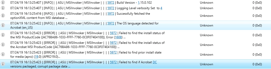

and will not install.  If I check the PDApp.log, the following is shown:
This particular package is just Adobe CC and Acrobat DC.  I have two others, one that is AdobeCC and Photoshop and one that is  AdobeCC and InDesign.   Both of those seems to work (although for InDesign the installer keeps going for what seems like an excessive amount of time before closing the window.  Even though the software has been installed for several minutes.).
I only get this particular error through the package with Acrobat. Tried with both 32 bit and 64 bit versions.
