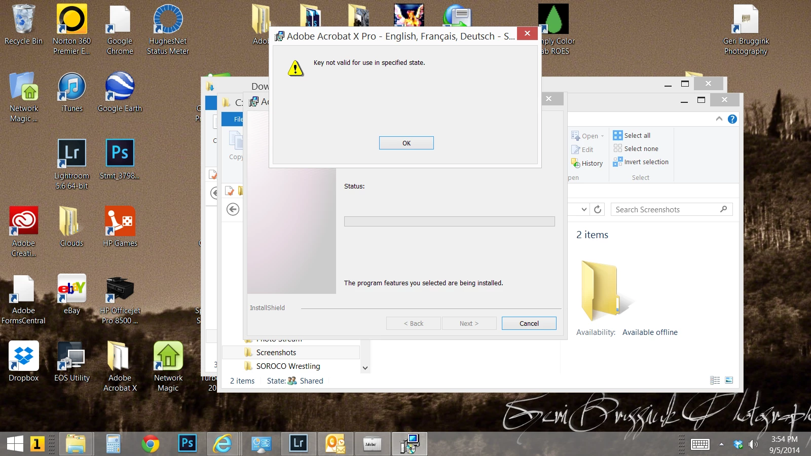

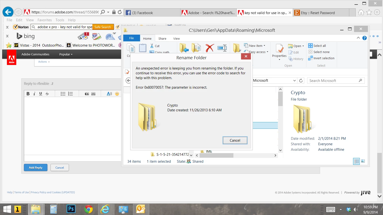

It does support it.
This is how I managed to install Acrobat X Pro on my system...
Instead of renaming the Crypto folder, I deleted it!  I then reinstalled Acrobat X Pro overwriting all files.  That worked!
Thanks anyway.

I cannot install Acrobat X Pro on Windows 8.1 64 bit.  I tried to rename the Crypto folder; however it wouldn't allow it.....
Any help would be appreciated.
Geri

September 10, 2014
Hi Geri,
Acrobat X does not support that platform. In some cases, the product will work on unsupported platforms, but this is probably not one of those cases.
http://www.adobe.com/products/acrobatpro/tech-specs.html#x
Ben
