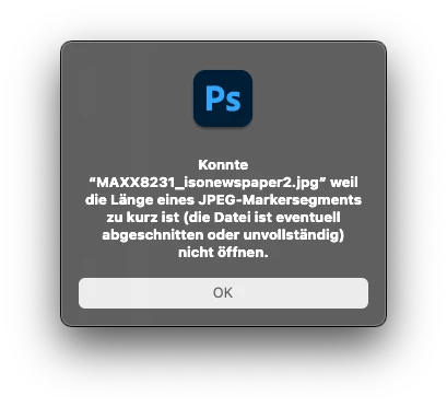

Sometimes it even is like opening an existing jpg from the share lets to a 0KB file after opening it. Then we get this message (due to the fact, that it is only 0kb)
