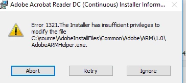

Now I tried using my method but it keeps saying this:
(Note the uninstall of the pervious version of adobe works great with the cleaner. The only reason I am using the cleaner is because adobe will not install on top of another version and this seemed to be the only way to remedy that)

First, have you looked at the following KB documents?
Fix Windows errors that occur during Acrobat Reader update
Error 1321 or 1309 when installing Adobe Creative Suite 5.5, CS5, or CS4 on Windows
Second, have you simplified the script to see which lines work and which lines do not work?

You are referencing the patch file twice and the MST file twice?  You shouldn't need to do that but then again you are using the MSI command line rather than the setup.exe command line so this should not make a difference.  If you use the MSI command line then the setup.ini is NOT invoked.
Question:  Is this working to remove the product completely when this line is run on it's own?  If yes,  then the only other thing that that I can think of to assist you in troubleshooting the cause of the issue is to create a verbose log for the installation.  That would be something like this:
msiexec.exe /i "C:\Source\AdobeInstallFiles\AcroRead.msi" PATCH="C:\Source\AdobeInstallFiles\AcroRdrDCUpd1700920044.msp" TRANSFORMS="C:\Source\AdobeInstallFiles\AcroRead.mst" /L*v "C:\Source\AdobeInstallFiles\AcroReadInstall.log" /qn
I hope this helps
