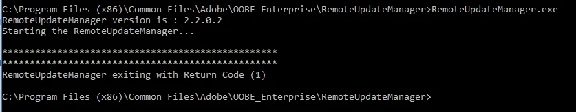

However when ever I try to use RUM to update the application, it gives the following error.
Also the following error.

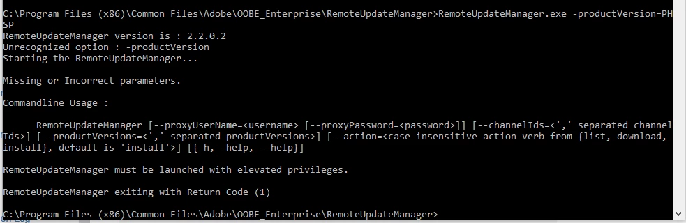

When I try use the product version command i get the following.
Now i am running CMD as Admin.

Return Code 1 is a Generic error so you would need to dig into the RUM log to see more.
Log locations - Use Adobe Remote Update Manager
In the second screen it looks like you are missing a dash. Should be --productversion
