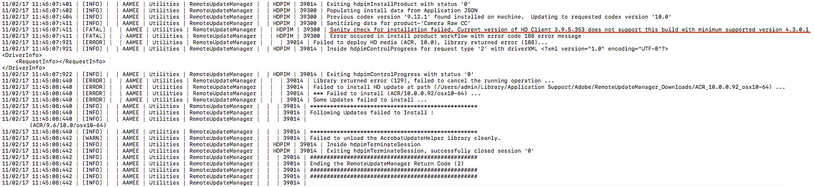

I'm getting the following output when I run RemoteUpdateManager. The problem seems to be when it gets to the "Sanitizing data for product" stage. The "Sanity check" fails because the HD Client is not the right version.
I don't know what this HD Client is, or how to update it. Anyone have ideas?
