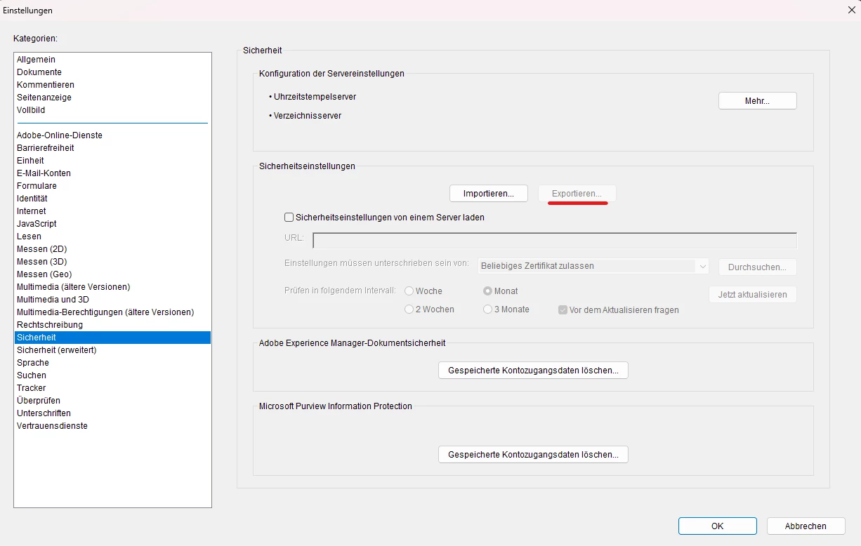

    Aug 12, 2026 8:24 AM UTC
    Hallo ​@AnkitVerma,
    Thank you for your response.
    I tried to export the security settings, but unfortunately I was not able to do so because the Export option is greyed out and cannot be selected. I am using the latest version of Adobe Acrobat, and I also tried running Adobe Acrobat as administrator, but the Export option is still disabled.

    Picture of the Security Settings
