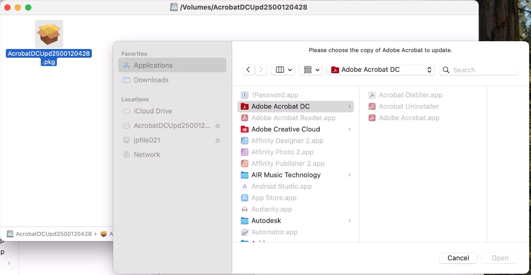

Hi AN,
Thank you for replying the issue.
We are using the dmg file package that is created by Adobe Console and we would like to use the update dmg in 25.001.20432 Planned update, Mar 11, 2025 — Acrobat-Acrobat Reader Release Notes to update the latest vetsion.
Because the latest version 25.001.20432 is not released in the Adobe Console. The latest version in the Adobe Console is 24.005.20414.
It seems that the AcrobatDCUpd2500120432.dmg does not apply to the version 24 installed.
How should we update the Acrobat for mac from the version 24 to latest version 25?

Mar 11, 2025 9:33 AM UTC
Hi @MashiIT,
Thanks for reaching out. As mentioned in the previous message, please verify the installed Acrobat version. The update package will only work if the base version of Acrobat DC matches the required version for this update.
To check the installed version, open Adobe Acrobat DC, go to Help > About Acrobat, and confirm the version. If the installed version does not match, you may need to install an earlier update before applying this one. You can refer to the following documentation for more details:
https://adobe.ly/41Ic3qu
Additionally, you can try creating a managed or self-serve package of the latest update from the Admin Console. After reviewing the Admin Console, I can confirm that the latest version is available for deployment.
