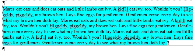

I want to create a paragraph tag with a colored background. Black background  - white text.
There is a font option allowing me to set a colored  background, and I can set a stroke above and below the text. But it seems I cannot totally avoid having a single, thin white line below the text.
Working in FM 2019. Is it really not possible to have colored background and extend the background color above and below the text?

Personally, I don't like the above look because the right margin is going to be ragged unless you set the Alignment to Justified, and even that isn't foolproof because once you hit return, that's where the shading ends.
I think you are using Paragrah Designer > Font > Background. StudioSM and I are using Advanced > Pgf Box, which doesn't care about the alignment. I think StudioSM's idea to use Frame Above Pgf and Below Pgf to pad the box is very clever—I just wish it worked as well below as it does above.

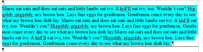

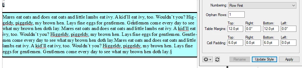

Hmmm. Somehow I missed the bit about the "stroke above and below". Are you saying that you are using a frame above and below the paragraph and that the white space you want to eliminate is between the line contained in that frame and the paragraph?
Going back to my suggestion of using the table cell, you can add a top and bottom border and adjust the cell padding until it's where you want it.
If you're set on using the frame above and below, I'm not sure what to suggest. You would definitely need to have the frame containing it on the reference page as tight to the line as you can get it because Frame uses the entire frame; it's not just the line, it's the space above, below, and to either side that appears in the Body.
With some experimenting, I've managed to tighten things up so that there's no gap when used in Frame Above, but there's still a very small bit of a space between the text and Frame Below that I can't eliminate, even when I set the Runaround properties to Don't and the Gap to 0.

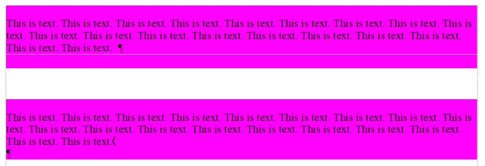

Hi StudioSm: That is truly odd, and something I haven't run into before. I tried multiple combinations of spacing values but could not remove the white line. I do recommend report this is a bug or feature request—I'm not sure how to classify it—here: https://tracker.adobe.com/#/home. Let us know when you do, I'll be happy to vote for it. You can reference this thread.
Top: frame above and below; Bottom: frame above and a line break
For now, other than the single-cell table idea that was already offered, the only other idea I had is to remove the frame below pgf and add a line-break at the end of the paragraph. Far from ideal, but might work for now.
