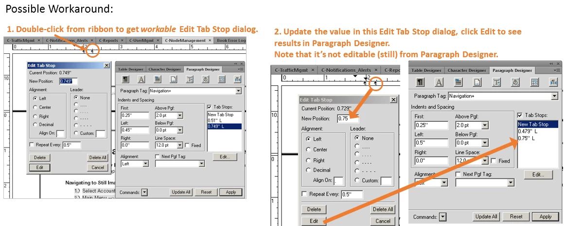

I think I have figured out a workaround:

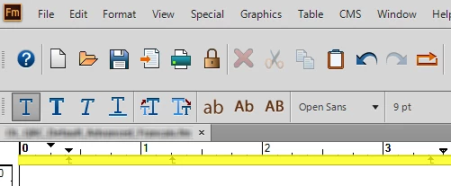

1. At the tab ribbon (top of page) click to set a tab (place the tab arrow).
You will see this setting correspondingly show up in the Tab Stops: box in the Paragraph Designer (which will refuse to be edited, per what has become the usual behavior). Ignore this and go to step 2.
2. Double click on the tab setting in the ribbon to get the Edit Tab Stop dialog. Adjust the values there, and click Edit.
Again, you will see the new value in the Tab Stops box of the Paragraph Designer; but now it is successfully updated (namely, it's sticking), and you can then apply/update all from the Paragraph Designer.

I did find somewhat of a workaround. If you are displaying rulers, just beneath is a thin strip. Click in the strip to add a tab stop. It displays as a bent arrow.
You can slide it left and right as required, and it shows up, and STAYS, in the Paragraph Editor window.  You still cannot edit it, however, and cannot add a leader if required (unless there is a special key combination that allows you to click to add a specific type of stop).
