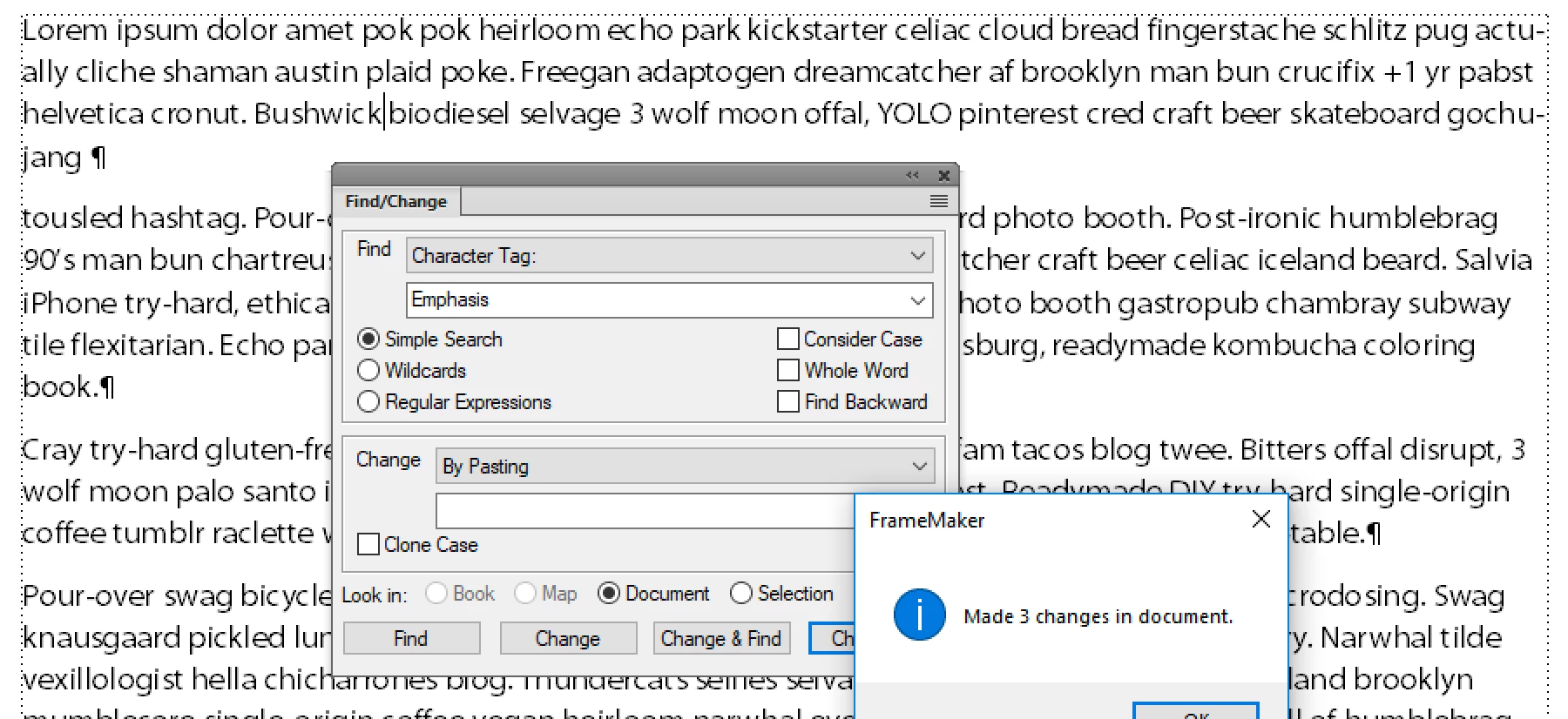

    Barb Binder
    Apr 26, 2019 12:55 PM UTC
    Hi Oscar:
    I think linsims is thinking about a past variation on this find/change scenario:

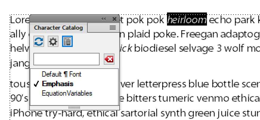

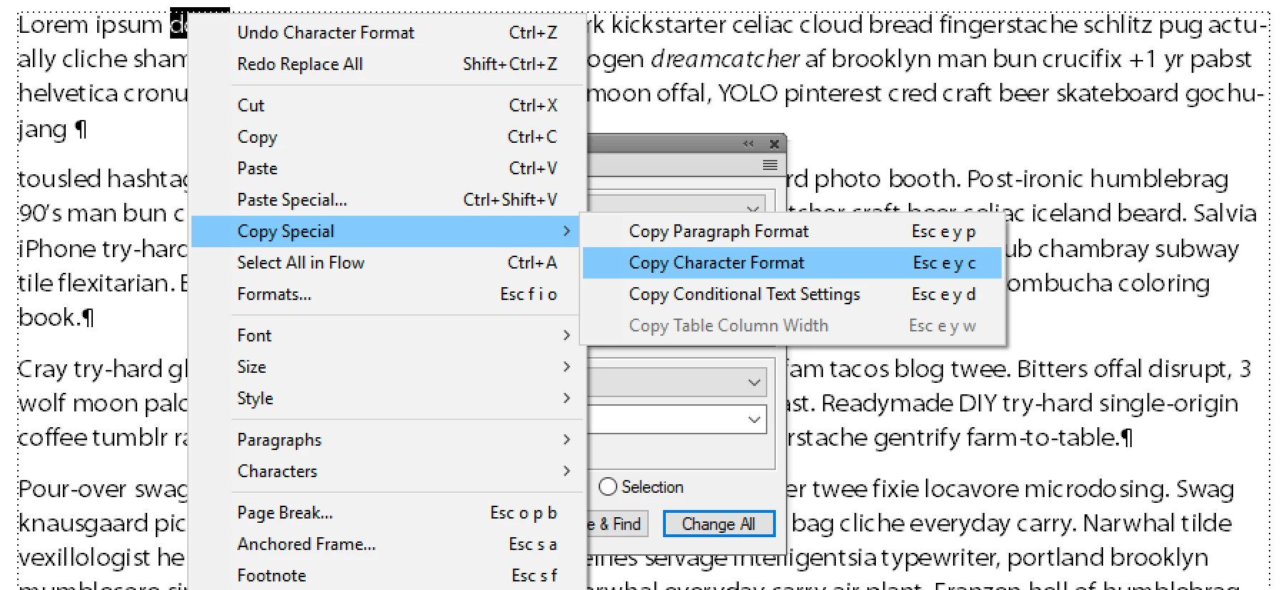

    1. Select text without a character style assigned. Copy the Character Format to the clipboard:

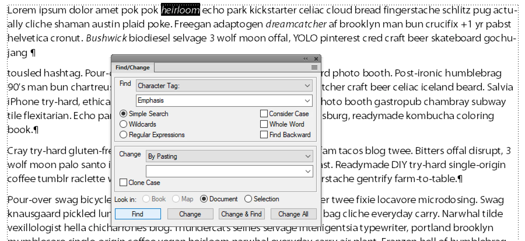

    2. Find the Character Tag. Change By pasting. (There are three occurrences of Emphasis in the first paragraph.)
    3. Change all.
    ~Barb
    LinSims
    Apr 26, 2019 1:04 PM UTC
    I think the one I was thinking of was recent, and you used the To Character Formats as the replace. I was discounting it, though, because it looked as if it would remove the tag, but leave the formatting behind instead of changing to the default paragraph format. My mind is tapioca this morning, though, so it's possible I misremembered.
    Barb Binder
    Apr 26, 2019 1:16 PM UTC
    Tapioca? Great description, Lin!

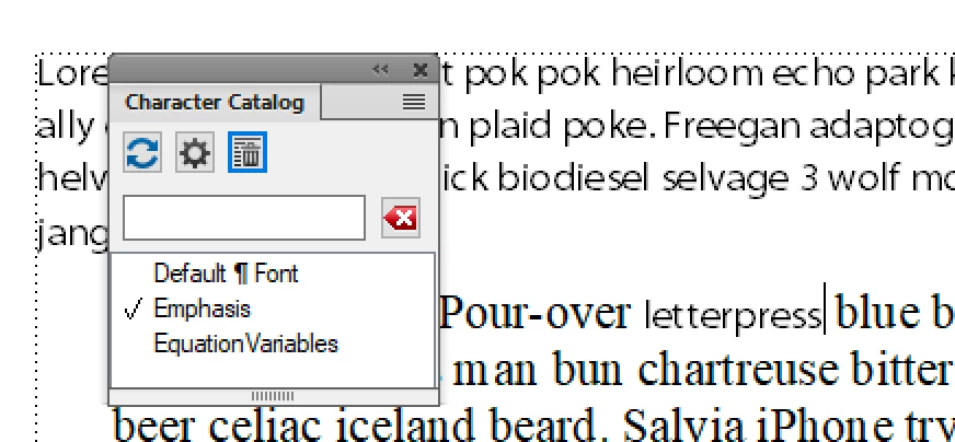

    I use a number of variations on this theme—the docs I lay out are so messy that I have learned to be creative in my clean-up. The f/c scenario I laid out above does remove the character tag:
    But the limitation is that it will muck up the formatting with different type specs, as would the variation you described above.
    ~Barb

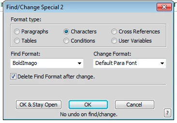

    Apr 26, 2019 12:27 PM UTC
    There has been a plugin named "FindChangeSpecial" by Rick Quatro (Carmen Publishing), which did exactly what you need: find a selected format (paragraph, character, etc.), and replace by a different format (including the default para font). This is a screenshot of the plugin in action:
    This plugin seems no longer available from Rick's website, just the more powerful successor, the "FindChangeFormatsBatch" plugin. However, you could simply ask Rick (via his website) if he still offers the "simple" plugin.
