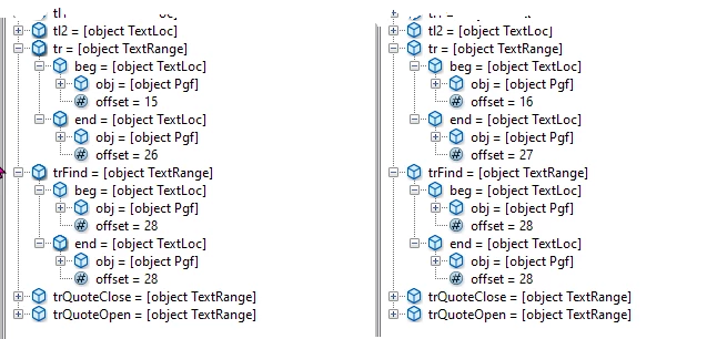

The main probem is here:
var trFind = new TextRange();
    trFind.beg.obj = trFind.end.obj = tr.beg.obj;
    trFind.beg.offset = tr.end.offset + sQuoteOpen.length + sQuoteClose.length;
    trFind.end.offset = trFind.beg.offset;
$.bp(true);
    tr = oDoc.Find(trFind.beg, findParams);
At he break point the variables have the status as shown to the left and after executing the next statement (find) the status depicted on t he right:
→ Although trFind points to the location after the closing quote, the object is found at the old location.
I have explicitly set up an independent object trFind, as I know that o2 = o1 makes not a copy of object o1, but an 'alias'. What's going wrong here?

The main probem - various findings
  1. Even if I set the position to start the next find explicitly outside the first range, I get the same bad result:
    trFind.end.offset = trFind.beg.offset = 35;​
  2. This is t he result, if maxLoop is set to 2 (4 iterations):
  3. The search advances correctly, if nothing is inserted. Hence I must check the insertion process more carefully.
