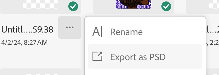

April 2, 2024
2024 update that worked for me
i press the three dots outside of the project and on the main screen, the I pressed export as PSD
i tried all of these methods but only this worked

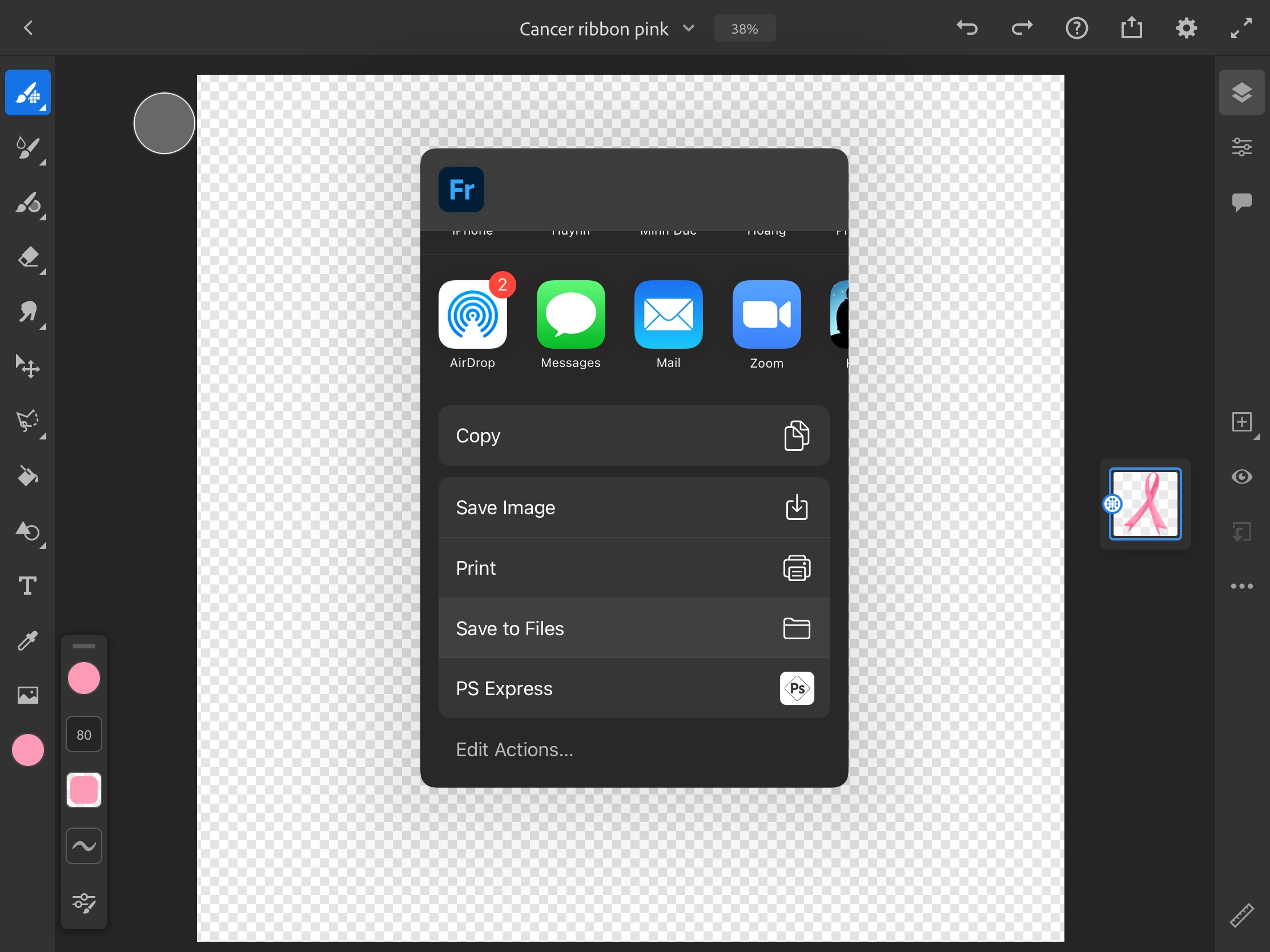

Actually, as an update, I tried both "Save Image" and "Save to Files" and got a transparent PNG both ways... Please share your exact workflow and we'll figure it out.

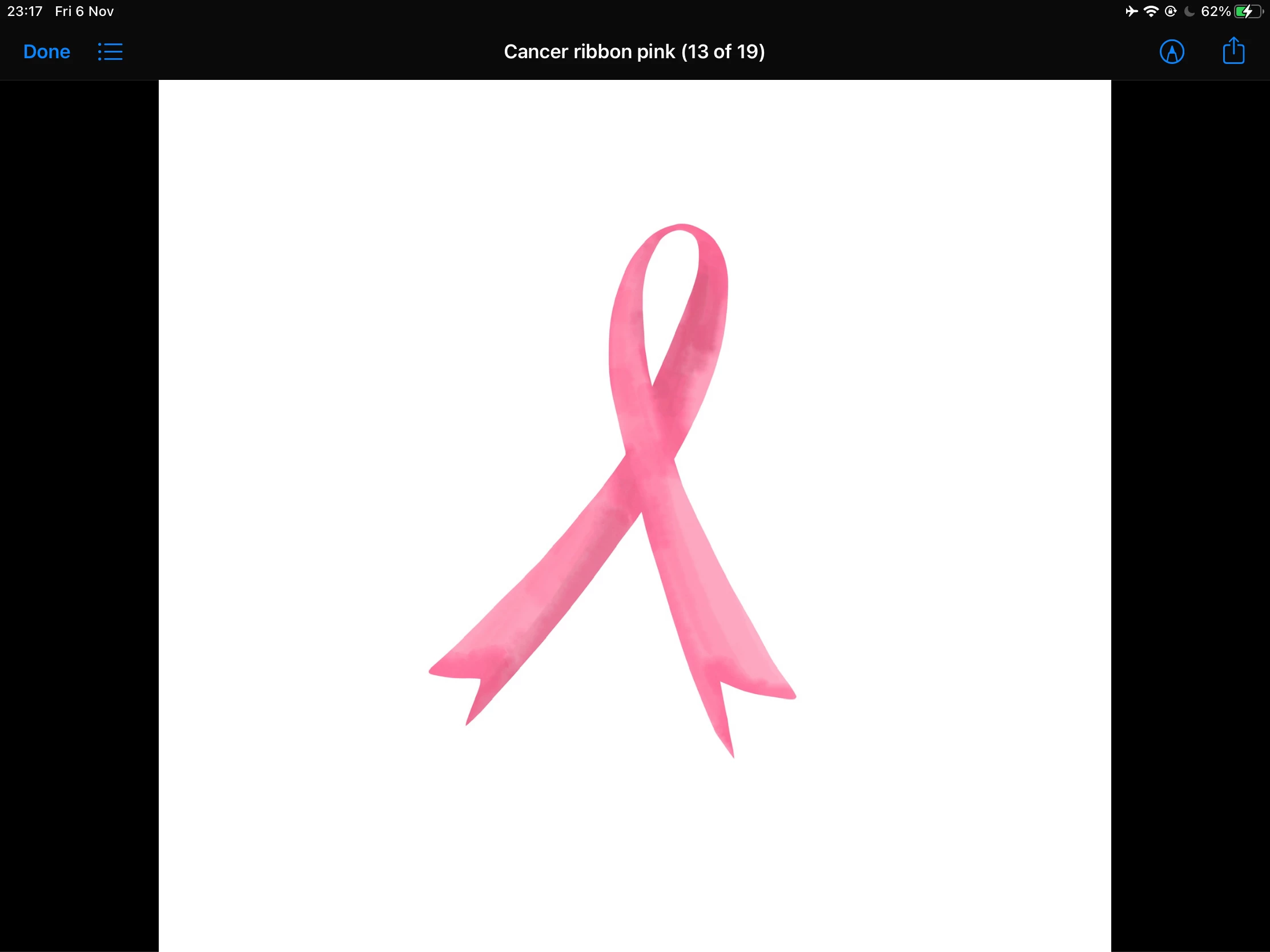

November 6, 2020
So I tried to save mine in files like you said but it still has a white background. What do i need to do?

I'm not sure why you're getting JPG, I am getting PNG when that's what I chose, and that includes transparency.
Are you exporting via "Save to Files" and not "Save Image" as I mentioned above? Please list your exact steps one by one and we'll see if we can figure out where it's going off the track.

How are you exporting?
If you want a transparent PNG, use "Save to files," and not "Save Image."
December 28, 2019
I did this and the end result is jpg, not png.
