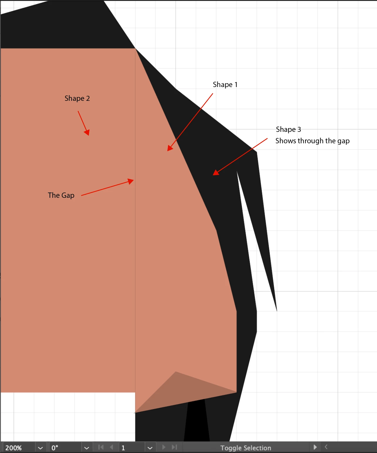

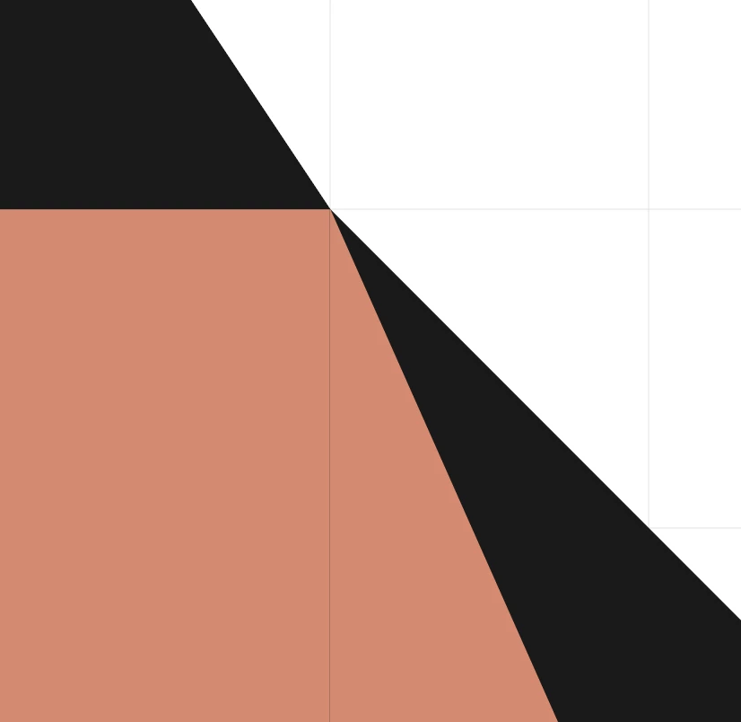

Tony Khoueiry
July 13, 2023
 this might make it more clear
