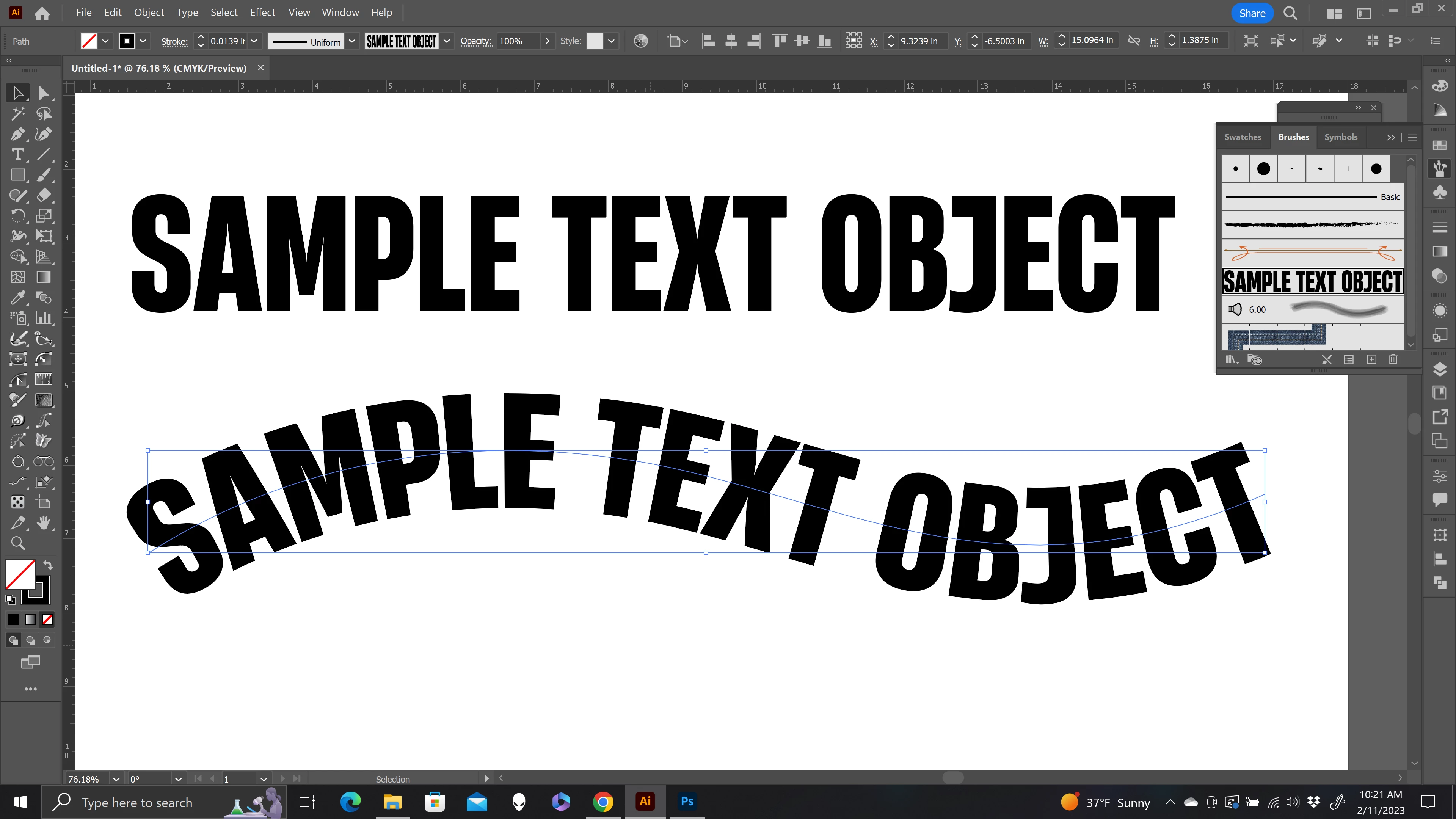

Text on Path effects are a very imperfect thing. The way the letters get rotated as they follow a curving path can yield a jumbled or even wacky looking end result (especially if the letters are big in relation to that target path). Stock letter spacing (or tracking) in a font will be thrown off when a text object is applied to any curving path. That's just a matter of geometry.
One possible solution: turning the type object into an Art Brush and applying that to a path. This is not a perfect solution, but it is one where the spacing between the letters will be maintained. The letters themselves will bend in relation to the path rather than merely rotate. In some cases it delivers a more desireable effect. The Width tool can deliver some really dramatic looking effects. I've done things like adjust the lettering I turn into an Art Brush to match the path length of the target path to get more fine tuned results.

Usually I have to convert the text to outlines to turn it into a work-able Art Brush. Given the realities of geometry, the Art Brush approach I offered is the only easy way to precisely preserve letter tracking of a text object applied to a path. Otherwise you will have no other choice but to manually kern each letter on that path one letter at a time. And you have to live with how the rotated looks appears. If that isn't good enough you have to convert the text object that's affixed to the path into outlines and then manually rotate and move each letter one at a time.

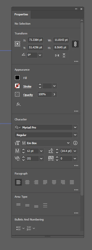

I understand that your text is outlined, is that the case?
If it is, you won't have access to the font options, because it's no longer a font
when it's still a font, all the options will be available if you click on the word "character" on the top bar
Or the properties panel
Obviously you will need first to type your text on a path
Hope it all makes sense!

You can change the kerning (so individual letters) before creating the outlines if that's what you are fater. After creating the outlines, your options will be limited with what you will be able to place by hand or use @Jacob Bugge 's solution below.

Monika Gause
February 10, 2023
Text on a path.
And then you can use the Tracking and Kerning settings in the Character panel.
