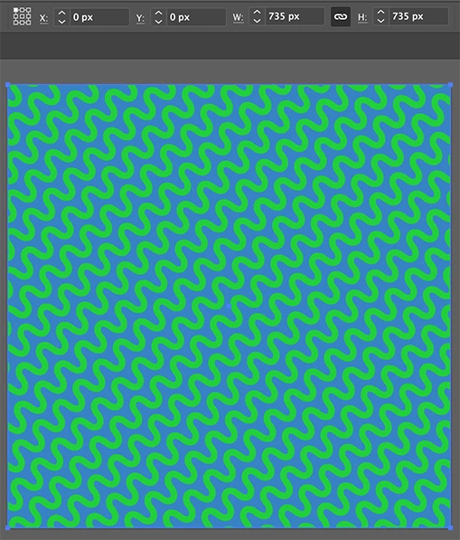

I am trying to create the attached into a seamless print however, I am coming across issues making it seamless given than there is a slight angle change and I was hoping someone would be able to assist without having to completely change my pattern. It started off as layer one but I wanted to scale it down to 60% and rotate it 315 degrees and now it is no longer seamless :(. Thank you in advance for your help 🙂

Correct answer Ton Frederiks
Diagonal pattern tiles are difficult to create.
A very good document about diagonal patterns from Teri Petit (one of the first Illustrator programmers) can be found here: http://tpettit.verio.com/adobe/index.html
Dowload (right click): Constructing Diagonal Pattern Fills (AI 9) and remove the .ps
As far as I understand your problem, the end result should be a rectangle with a single seamless repeatable pattern element.
This is not easy to do with a transformed pattern.
The method shown below (using effects in the Appearance panel) is by scaling the pattern box until it looks seamless. This can result in very large tiles (to infinity and beyond!).

Thank you for all your responses it has been really helpful. As Ton illustrated, I needed a complete pattern 'cycle' or 'repeat' in one rectangle to work with and I had a feeling I would need to make the space incredibly big to ensure a complete repeat was captured as Ton confirmed. Thank you for your help I have gone with that solution and scaled it down to ensure my file size is no extremely big. Thanks again!

I think we both understand it different. I understand that he wants to export/save the pattern in order to be able to use it in an application like Photoshop (or an app that prints patterns) and define it there as a pattern. How do you export your example and use it in Photoshop as a pattern?

You need a much larger tile to make it seamless.

August 26, 2021
this is what I suspected. Do you know if there is any alternative? For example, would tweaking the lines resolve it. I would assume increasing the angle would mean the tile would have to be smaller but ideally I would like to keep the angle
