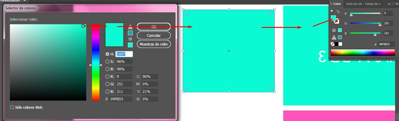

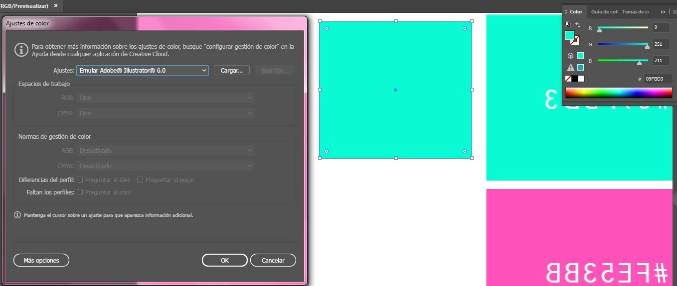

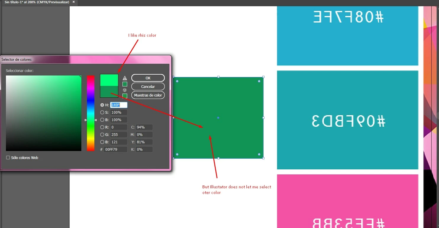

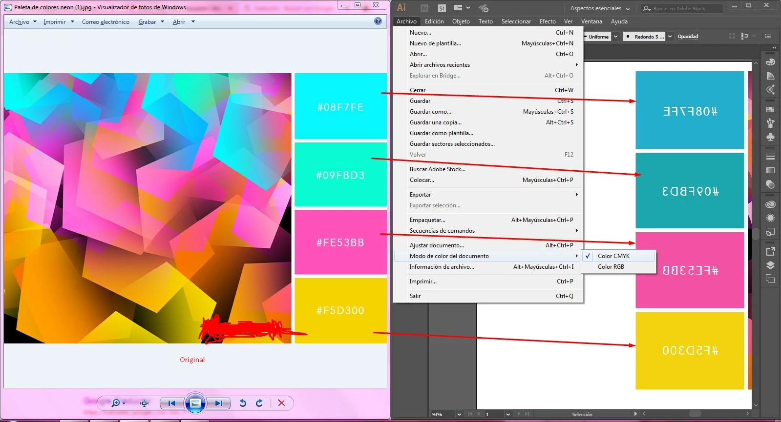

Hello a few days ago in Illustrator 2017 to start a new project with neon colors but when I export the image this was the result
when I try to reach a more saturated color illustrator does not let me

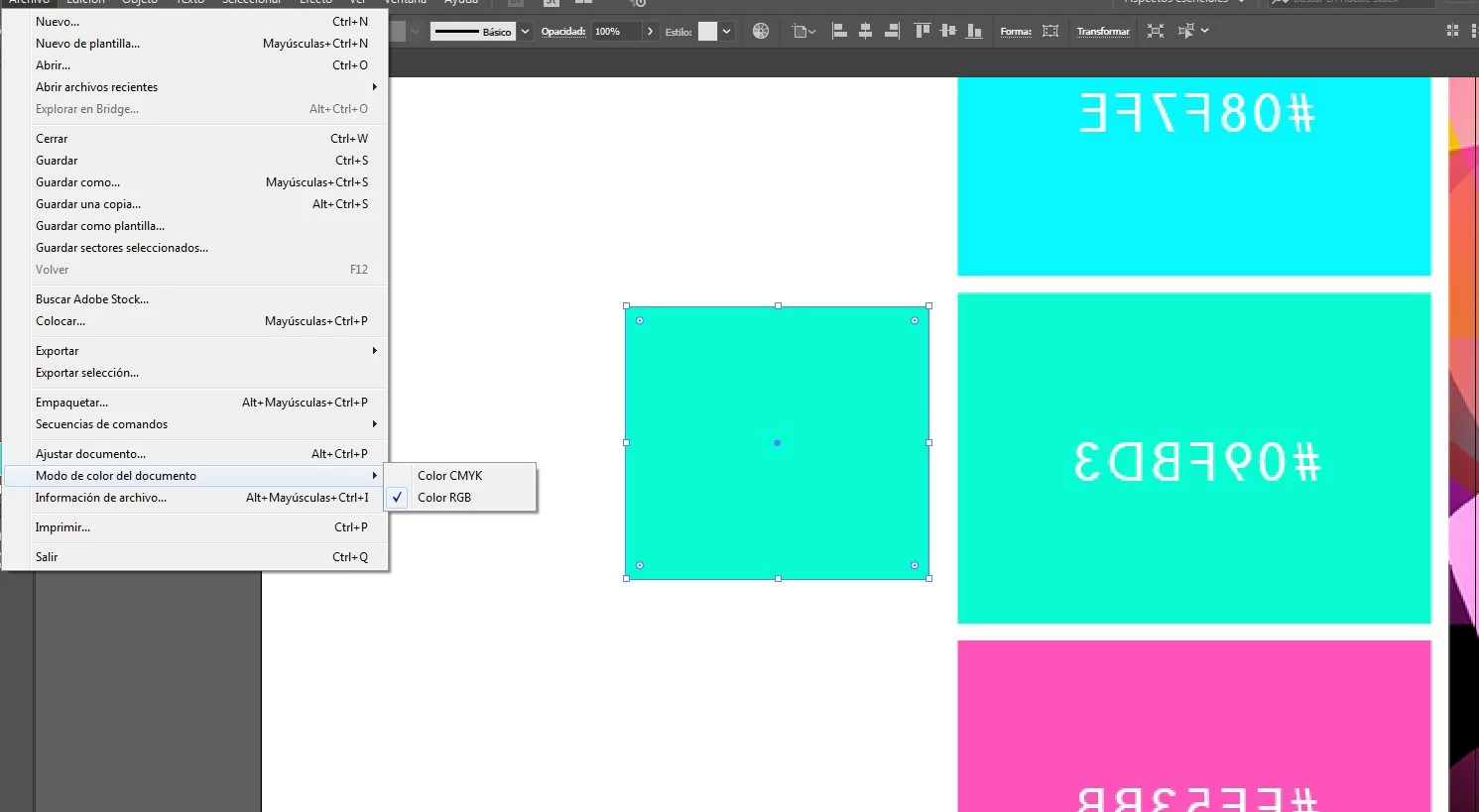

when I change the color model to RGB everything goes well
The problem is that I want to print these colors for a poster
Can somebody help me

alan javierc52965949
March 16, 2019

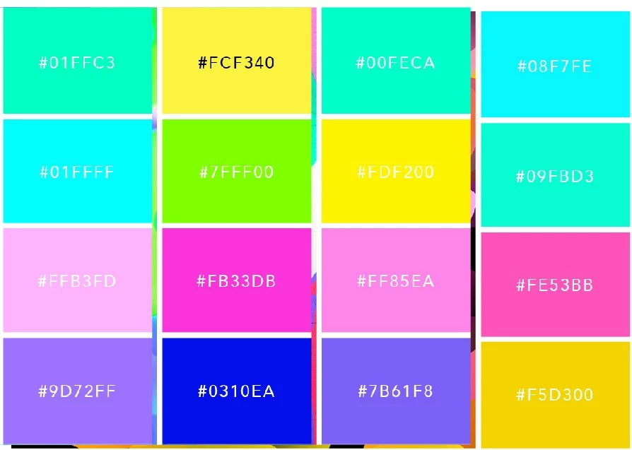

What do you recommend to me to achieve a range of saturated CMYK colors that look more like neon colors?
For example
March 16, 2019
You can’t make colours anything like that. Maybe a CMYK swatch guide would be useful.
March 16, 2019
Monika Gause

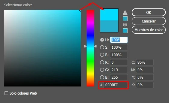

thanks for the answer, you know why illustrator in CMYK mode can not reach this tone #00DBFF
Monika Gause
March 16, 2019
It can't be reproduced with proces colors.
Maybe it can be reproduced with spot colors such as Pantone.
Please learn about print production.
