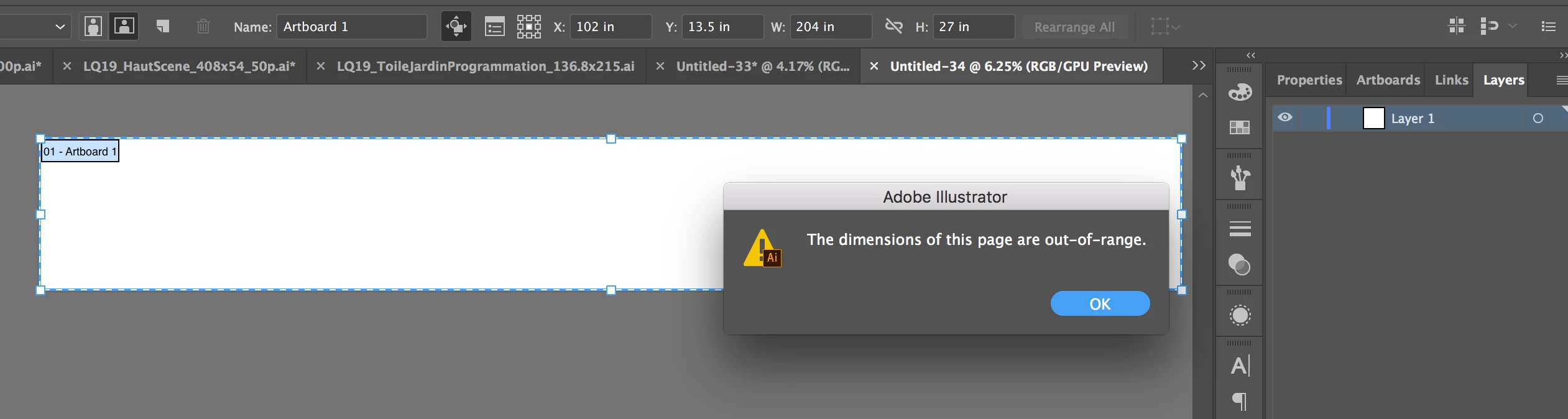

Jul 9, 2019 4:56 PM UTC
ok .... I got it .... You can't export more than 200 inches wide.
200.1" and the system blocks it. So make your artwork smaller than this.
Jul 9, 2019 2:41 PM UTC
I have the same problem. If I create a new document with the same dimension with no artwork at all, I still have the same problem ... dimensions are out-of-range.
Document size: 204" x 27"

Oct 25, 2018 12:29 AM UTC
PDF page dimensions can not exceed 200 inches in either dimension
