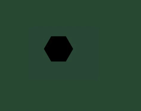

Exporting a PNG with a background does not match the Website Background
  • March 10, 2024
  • 273 views
My current issue is that i have exported a PNG with a background, however it does not match the shade on the website as you can see that there is a slight shade difference. Is there anyway to rectify this issue?
Any help is welcomed !
Thank you.

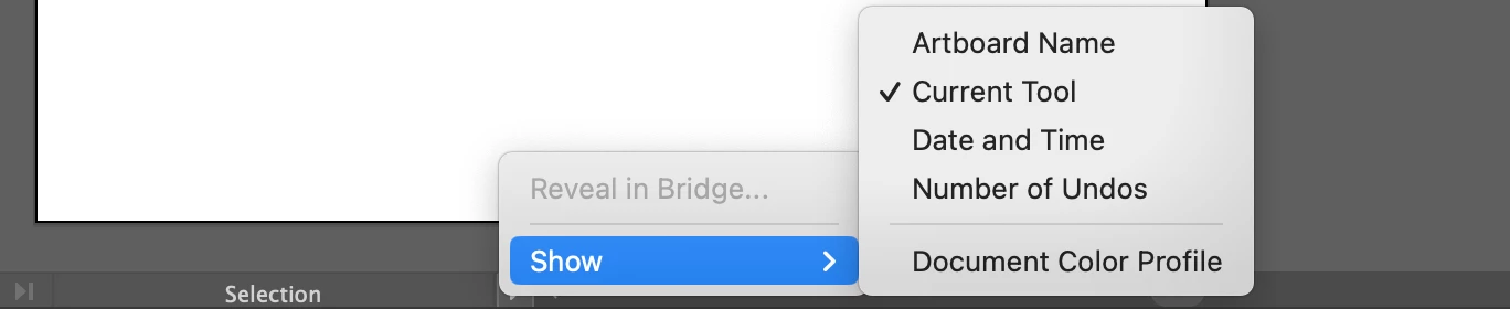

What is your document color profile? PNGs exported from Illustrator use that profile but Illustrator does not embed it.
Other apps just think it is sRGB, which could be a wrong guess.
You can check it here at the bottom of your document window.
