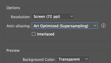

    December 8, 2023
    AI v.27.8, using the regular Export As option (cmd E - see screenshot below of the options).
    In that file, there's 12 artboards that I export in 2 batches (1-6 + 7-12).
    The job is to take an admat and reformat it in many formats used for web and screens. I've been doing this over and over (more then 3k different formats over the last year), using always the same method. And on that specific file, the system added the number of the artboards at the end of each file exported.
    The software did not update lately as I'm doing it manually. I just don't know why it started doing it. Oh yeah, and it did it only for that specific task of a specific design. I just did the same task, exporting PNG of another design in another file, and the system did NOT add the number of the artboard at the end.
    It seems to have done it randomly, or whatever the reason ...

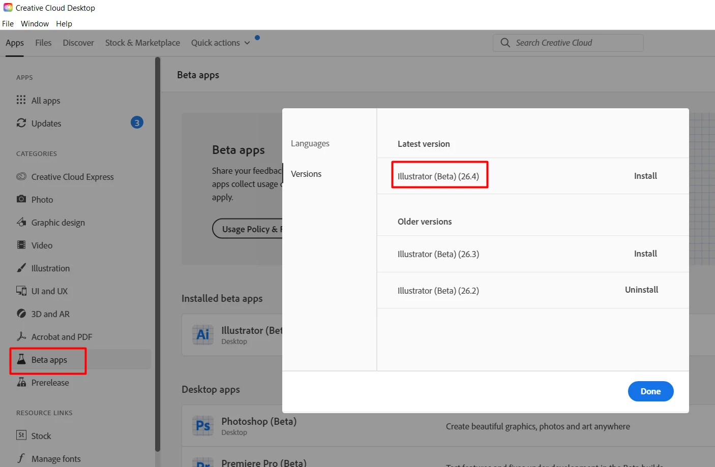

    Srishti_Bali
    May 12, 2022
    Hi Everyone,
    We have tried to fix this in Illustrator's latest beta build (v 26.4). We request you all to please download the build from the Beta section of the Creative Cloud Desktop app and share your observations here.
    Srishti
