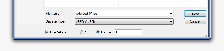

Correct answer Justin16
When exporting images from illustrator, you must always select "Use Artboards" when the export dialogue pops up.

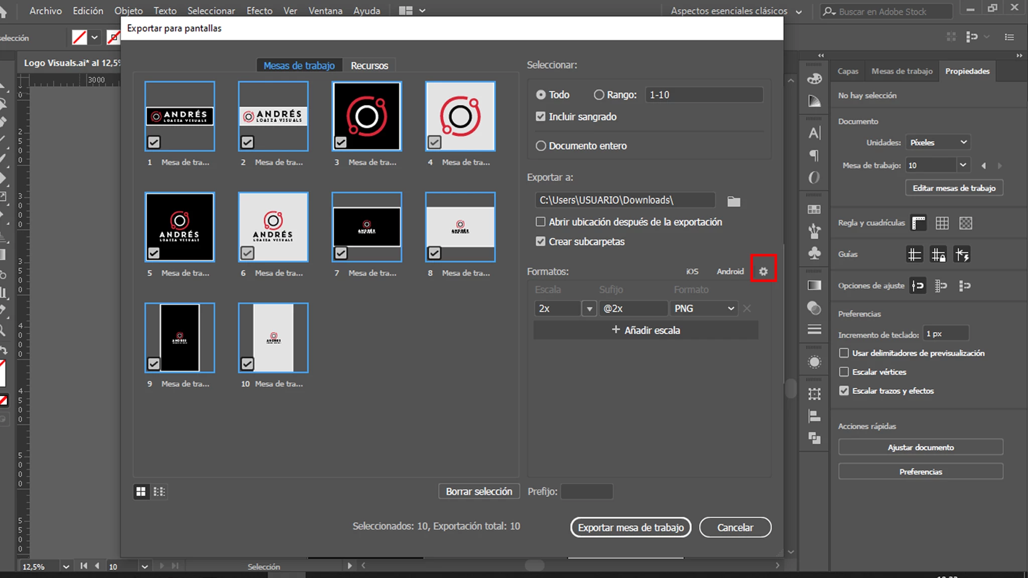

Andrés Loaiza Visuals
July 12, 2021
I found a new solution for those that couldn't fix it yet
When you are exporting click on the advanced options icon and then select Background color to transparent and that's it
It worked for me 🙏

January 7, 2018
I'm using AI CS6 on MacOS Sierra and I'm not seeing a box to check "Use Artboards". Ugh! What am I doing wrong?
January 7, 2018
Nevermind. I figured it out. I had to reduce the export box to see the "Use Artboards" option. Thanks for the original solution!!
