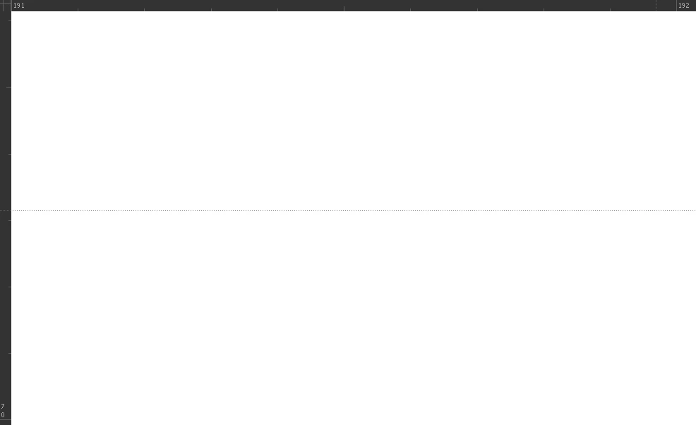

Ok so i'm pretty new to the program, the guides have been working but have suddenly stopped.
I can see the dotted lines when i pull from the ruler but when i release they don't show and disappear.
The layer is unlocked, i have smart guides ticked, i've checked and i'm not hiding guides, my colour is set to cyan.
So what am i doing wrong.
thanks in advance
