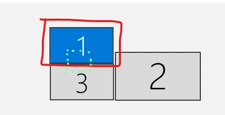

October 12, 2020
I have multiple screens and got the same problem on Windows 10. The table settings pop-up was displaying all the way up (and above) the screen. I solved it this way:
1. Re-create the error (I opened the table settings pop-up).
2. Open display settings (in windows) from the desktop > right click > display settings
3. Move another window above (depending on your case) and click apply. (see screenshot, red is the moved screen and dotted green is the faulty pop-up).
4. Now the top of the pop-up is showing on the screen above the faulty one and you should be able to move the pop-up to the right position!
5. (optional) move back the screens to the original position within display settings in windows.
