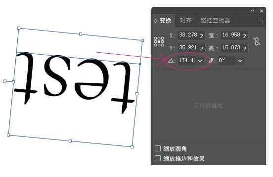

For example, the above red line mark ,how to use API to get it
Correct answer Rick E Johnson
I had done several tests regarding getting and setting accumulated rotations and summarized my findings in a post on this forum. Unfortunately, since Adobe changed the software for this forum, I've not been able to search for that post and other related discussions. I have some comments in my code, though, that may prove helpful, that I'll share with you.
I found that simply reading tags with the AITagSuite would sometimes cause a crash, so I ended up using dictionary entries instead. I use Hot Door's CORE, which directly supports dictionaries, so my code is a bit simpler than the SDK's.
bool success = tempArt->dictionary()->getStringEntry("BBAccumRotation", rotStr);
// now convert rotStr to a number
The string in a dictionary or tag can contain up to 16 decimal places, but I use 8 because 16 will crash Illustrator's Free Transform tool.
Illustrator's Properties panel doesn't seem to work the same way the Info panel does. I don't have notes on exactly what is different -- I think that info is in my lost forum post.
When getting the rotation of a group, I look at the rotation of the topmost object within the group.
I hope this is helpful.

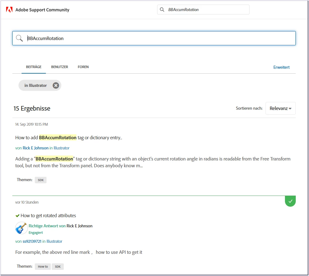

Great! I see if I search for "BBAccumRotation +sdk" it narrows it down much better.
Now people searching for info on BBAccumRotation with the SDK can find relevant info more easily!
Thanks!
Rick E Johnson
February 16, 2021
Awesome! But I can't find where to add the "in Illustrator" or "SDK" attributes.
