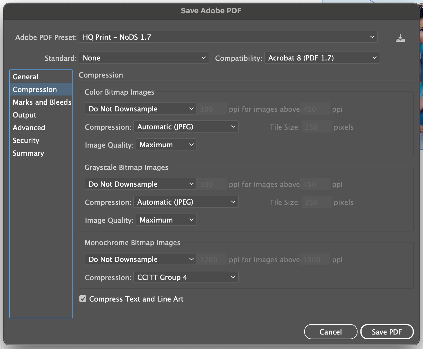

Dec 19, 2024 3:36 PM UTC
I've found that turning off the Compression options when I "Save As" (Acrobat 8 PDF 1.7 Compatibility).
Under "Compression," I Select "Do Not Downsample under: Color Bitmap Images/Grayscale Bitmap Images, and Monochrome Bitmap Images.
This Solves my print quality issues.
I just wish there was a way for it to appear at actual size that RIP—instead of enlarging 1000%
