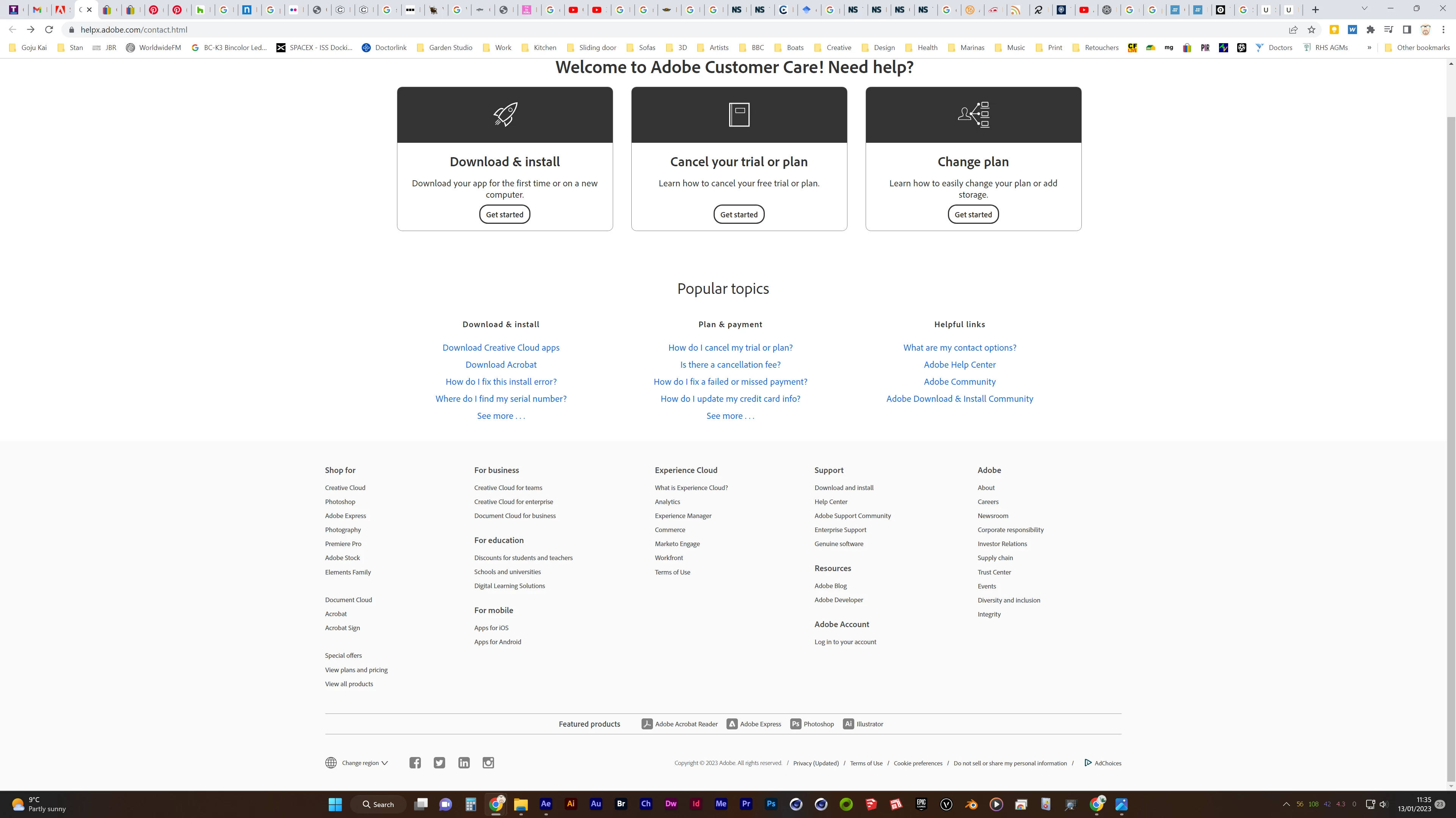

https://helpx.adobe.com/contact.html (you need to be logged into your Adobe ID, the chat is in the bottom right of the window)
Hi, afraid I can't see any chat window and there are numerous links on that page. Do you have a direct link?
