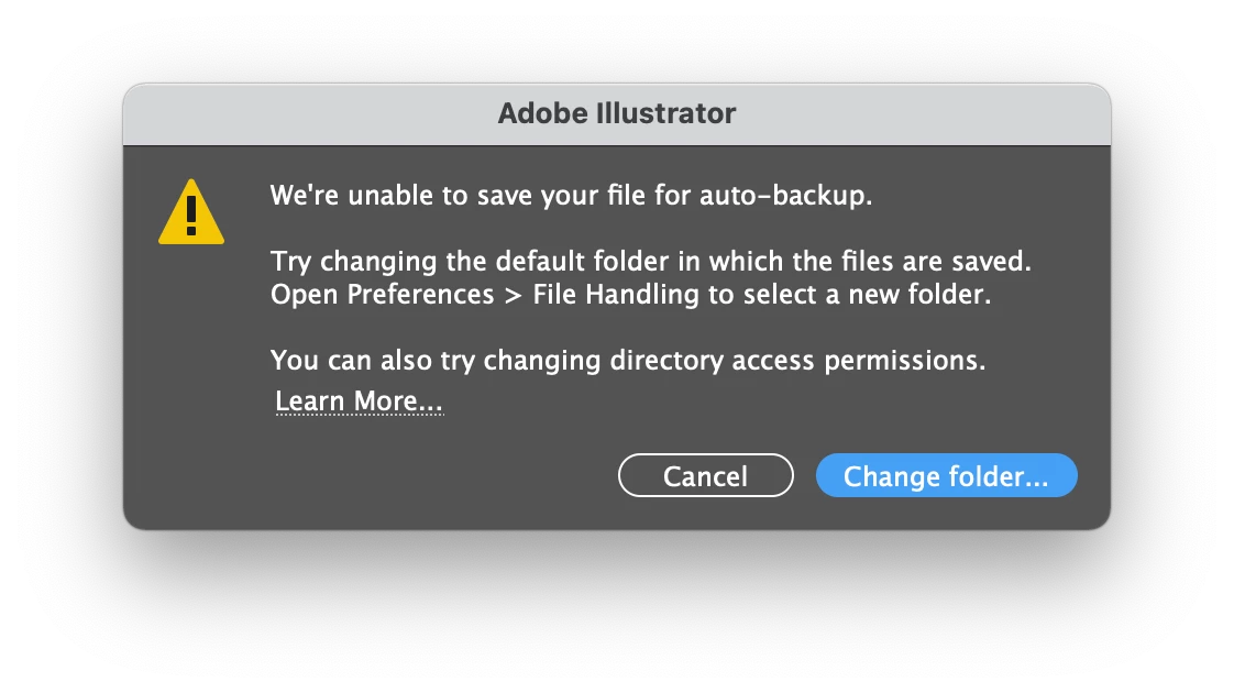

Illustrator auto-backup folder error "We're unable to save your file for auto-backup."
I keep getting this error, have tried to change the location of the folder to several places where I am sure permissions are for everyone to read-write, with no luck. Anyone else having this problem? And figured out how to solve it?

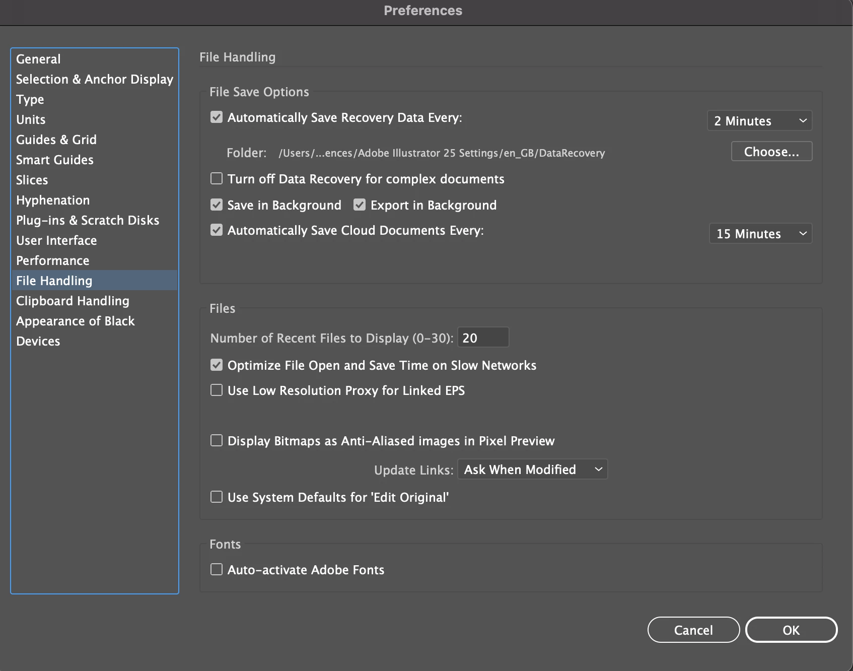

I missed your comment my first time reading this thread, but I noticed the same issue for myself. Here's how I changed the folder.
1. Go to Illustrator File Handling preferences
2. Select "Choose..."
3. On Mac, press Cmd+Shift+G
4. Type in this path exactly:
/Users/YOURUSERNAME/Library/Preferences/Adobe Illustrator 26 Settings/en_US/Data Recovery
5. Choose that folder
6. Select "OK" in the preferences window, and you're done!
You might also need to navigate to that same folder in Finder and enable "Read & Write" access for the folder.
This seemed to fix the problem for me!

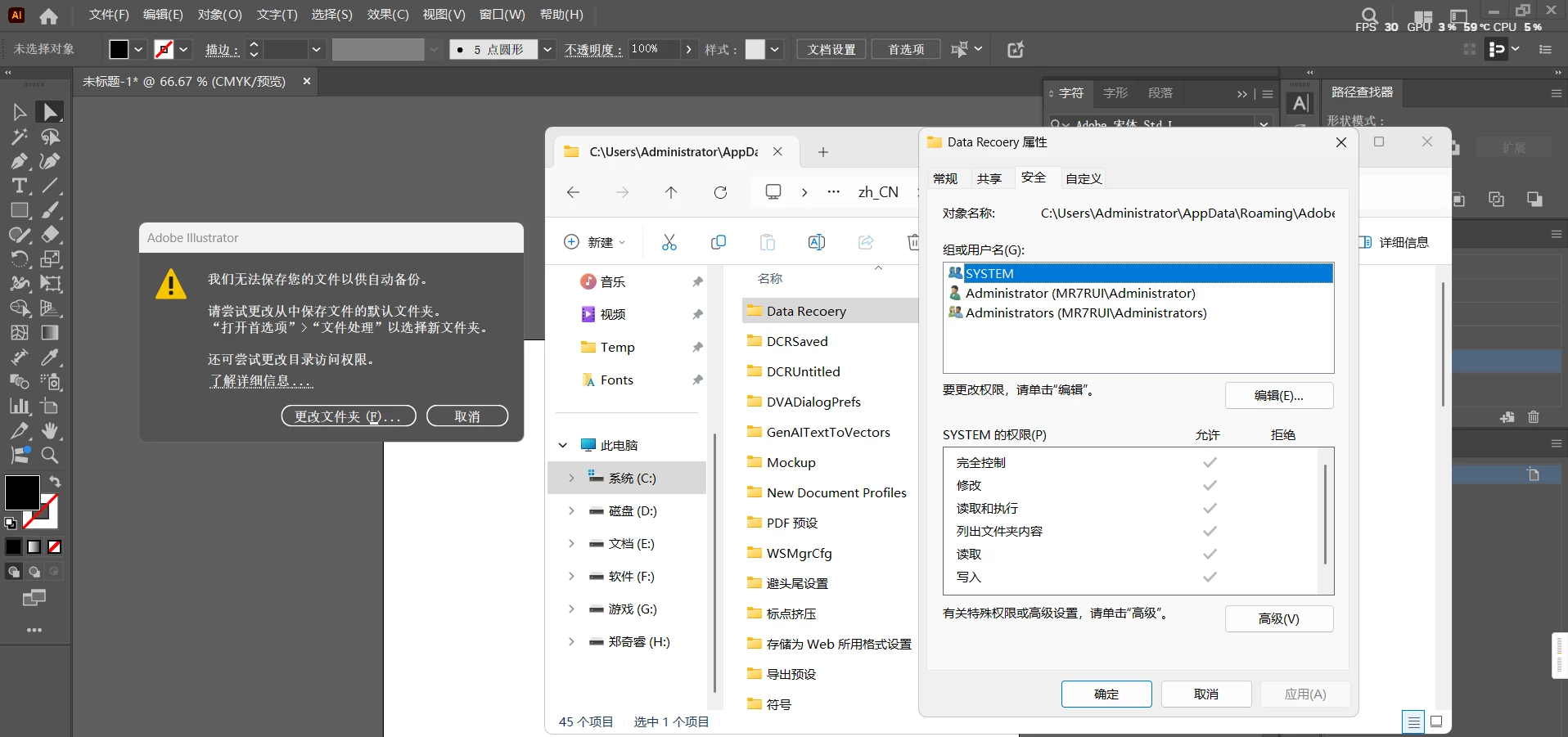

Dec 21, 2024 2:11 PM UTC
I have enabled all permissions but every time I turn it on I get the same error

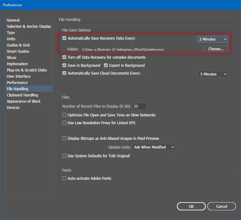

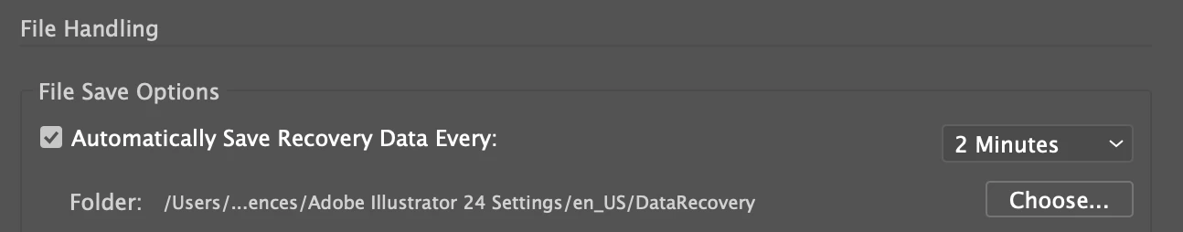

We have the same issue on Windows 10 version 21H2 (19044.1645) for several users running AI 26.2.1.
For the affected users, the Data recovery folder is pointing towards the Illustrator 23 Settings folder which no longer exists on those computers. For me, it points to Illustrator 25 Settings which is not correct either as we are on version 26.
So far, manually changing the path to point to the correct version 26 settings folder fixes the issue but that should not be something a user has to do on their own after an update.
Expected behavior: when updating Illustrator to a new major version all settings folder references are automatically updated to the correct and existing new settings folder.

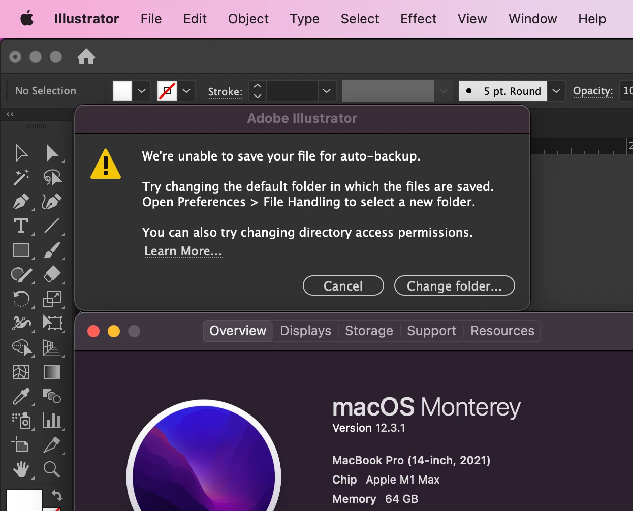

I still have this issue unfortunately, but I'll write to provide some clarity. I'm using a Macbook running MacOS Monterey version 12.3.1 with the Apple M1 Max chip and 64 GB RAM. The Illustrator version is 26.2.1.
This started occurring on a brand new Macbook with a clean install of Adobe Creative Cloud. I did not have the issue on my prior Intel-based Macbook.
I tried working with Adobe's support team, but once they took remote control of my desktop, the only thing they did was disable auto-save completely. Sure, this made the notification go away. But it did not address the core issue, because I do want auto-saves to occur as I'm working on documents.

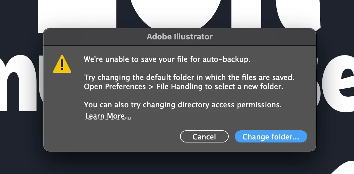

Apr 14, 2022 3:12 AM UTC
I started having the exact same problem a few weeks ago. It happens when I create a new file. But as soon as I save the file somewhere it goes away. So I just cancel out of the error message, save the empty file as whatever I want it to be wherever I'm planning to work on it, then auto-save proceeds quietly as usual.

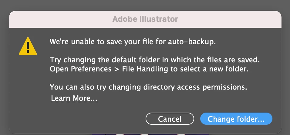

Still have the same issue even after the last update, I lost so many files because of this issue. I'm starting to get angry. Illustrator is the only one that when it crashes isn't doing the auto-recovery. This is getting out of hand.
Illustrator v26.2.1.
I have a Macbook pro 15" 2018 with a Radeon Pro Vega 20 4 Go
Please fix this issue

Still having this issue as well. When I go into my preferences, it's still linked to a version 24 directory in the libaryar, which no longer exists:
~/Library/Preferences/Adobe Illustrator 24 Settings/en_US*/DataRecovery
…but I have been unable to change it to the "Adobe Illustrator 24 Settings" directory because the Illustrator file finder interface does not allow me to navigate to the Library direcotory, or even manually type in a directory path.

Sorry about this trouble. This looks like a permissions issue on the Data Recovery folder. Please provide read and write access to data recovery folder on the following locations. Steps are shared here:
On macOS:
~/Library/Preferences/Adobe Illustrator <version number> Settings/en_US*/DataRecovery
On Windows:
C:\Users\USERNAME\AppData\Roaming\Adobe\Adobe Illustrator 26 Settings\en_US\x64\DataRecovery
Do try these steps and share your observations with us.
